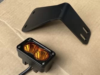

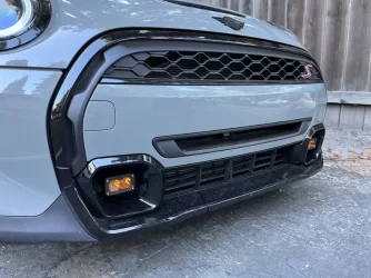

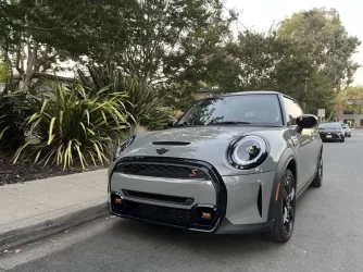

Put some fake exaust tips in the rear bumper, and fog lights in the front air scoops:

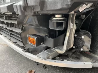

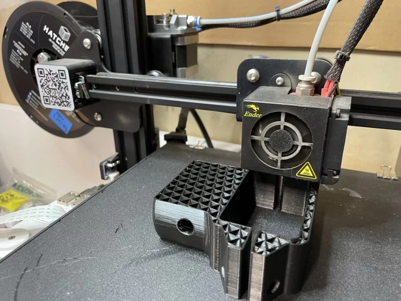

Designed some steel brackets to mount the fog lights using some existing holes in the bumper supports. Bolt in and slotted for up/down/left/right adjustability. Pretty happy with how they turned out.

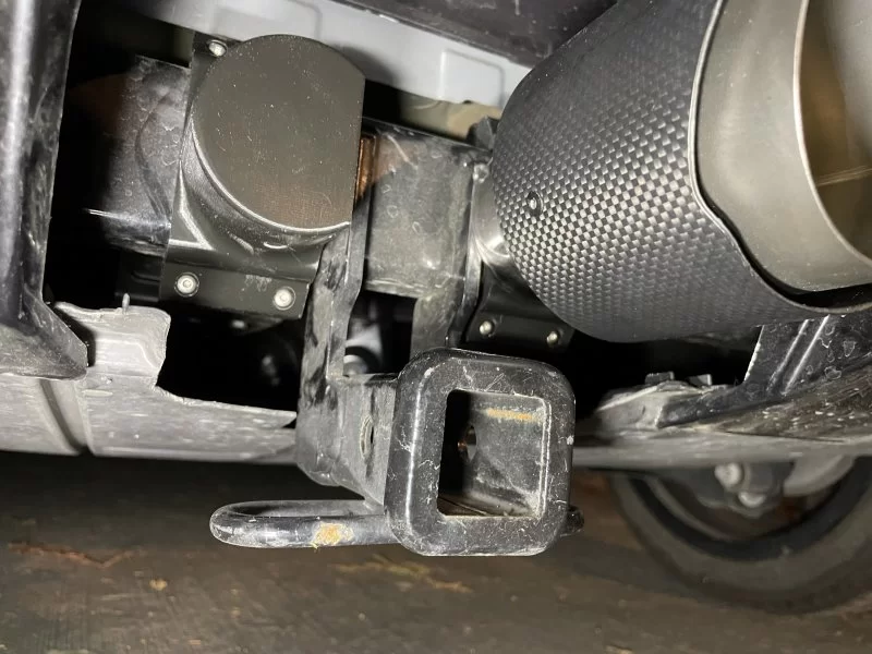

Do you have any pictures how you attached trailer hitch and what hitch you bought
It's this Curt C11417 Hitch from eTrailer.

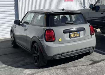

The hitch fit very cleanly under the stock SE rear bumper. I trimmed a 2" x 3" rectangle of plastic out of the under-tray to fit around the hitch receiver, and no modification needed to the bumper. I don't have a good photo from below, but you can see the hitch receiver with and without a drawbar:

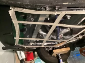

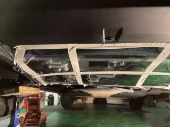

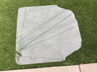

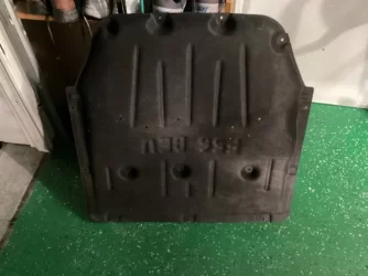

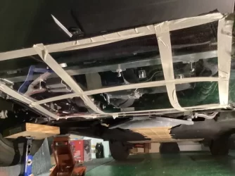

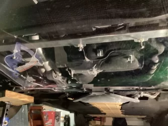

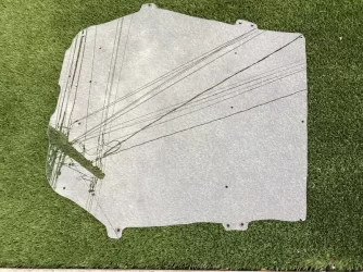

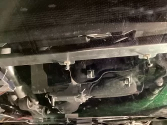

Maybe you will be interested what I did once you look to improve efficiency /airflow What I did to SE to improve air flow under a car and make stronger in case I hit some road debris I made a tread before is somewhere there .Once I crack some alloy oil pans on ICE cars in past I do this to all cars I drive . Is inexpensive $50-80 LEXAN which is crack /shatter resistant can’t damage with hummer.On SE I put 1/8” but could be 1/4 “is easy to mould with heating gun .On SE was not required to do any bending with 1/8” I use all fastening points the same way like factory .Some screws have to be longer.Masking tape on those pictures is only for pictures purposes you will see nothing through clear Lexan just underbody of a car .

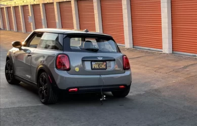

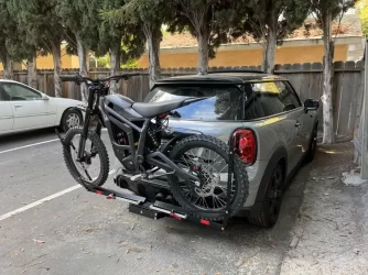

One more hitch photo for fun with the electric bike on the back:
Pretty sweet. What's the weight of that bike, and the max load of that rack? My e-bike is over 70 pounds but it's foldable and surprisingly fits in the back of the SE.
Did you loose any ground clearance .? from pictures I can’t tell and is possible install a hitch without taking bumper off I believe I shouldn’t ask that question.obviously you have to remove a plastic shields from below .Two years ago the only hitch available was like $ 500 hidden hitch and I never look again but once I see your installation I’m going to do it.Is $220 Thank you @ rob-sf

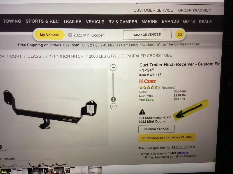

Before I order I went with your link to e-trailer and that what they said:not confirmed to fit ! Please tell me is a right one which you install on SE
The ebike is 117lbs with the battery removed. Hitch is 200lb tongue weight rating. Rack is 150lb max but only rated for 50 lbs per bike… to be seen how it fares loaded up like this. Can’t find any rack rated for 117 lbs that fits a 1-1/4” receiver.
Before I order I went with your link to e-trailer and that what they said:not confirmed to fit ! Please tell me is a right one which you install on SE View attachment 21782
Curt C11417 is the one I bought. To your earlier question, yes the whole rear bumper has to be removed for the installation.
