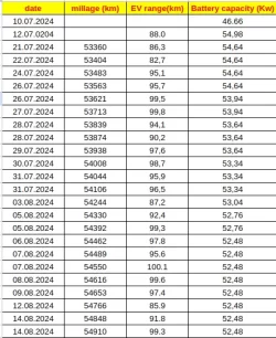

Bro, I did 4 full charge after reset. Sometimes use HV charge mode.
So few digits after reset
1st charge did 88.0km EV range SoC 99% 54.98Ah (city)
2dn charge did 86.3 EV range SoC 99% 54.64Ah (city)
3rd charge did 82.7 EV range Soc 99% 54.64Ah (highway 80km/h + a little stuck in the city traffic)
4th charge did 95.1 EV range DoC 99% 54.64Ah

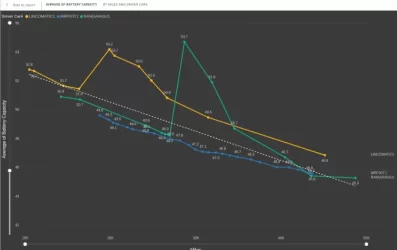

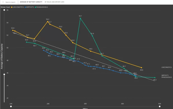

@MFKilla,
You can believe that you somehow rejuvenated the HV battery in this vehicle if you want.
The experience in this forum has demonstrated that these "Resets" are temporary, and over time, the capacity will return to where it was before the reset.
We have numerous examples of this. Here is plot that shows two examples (orange and green curves).
The blue curve shows normal behavior without a reset.
Note that the 'recovery' from one of these reset events can take as long as ~10K miles.
Keep watching your capacity over time (not from charge to charge, but from month to month).
I think you will find (like we did) that the capacity reading is false for a good while while the calculation recovers.
If your capacity remains this high, you have somehow violated the laws of physics !

My statistics. Last 8 charging capacity is stay on 52.48 Kw
Thanks for the data.
After 'resetting' the capacity, you have dropped by 2.16 aH in a month (1550 km, or 960 miles).
It will be interesting to monitor what happens going forward.. Although your capacity is 'flat' over the last 8 charges, it will continue to go down. If your car behaves like we have seen with others, I think the capacity will be near the 47 aH (what you saw before the reset) over the next 15,000 km.
