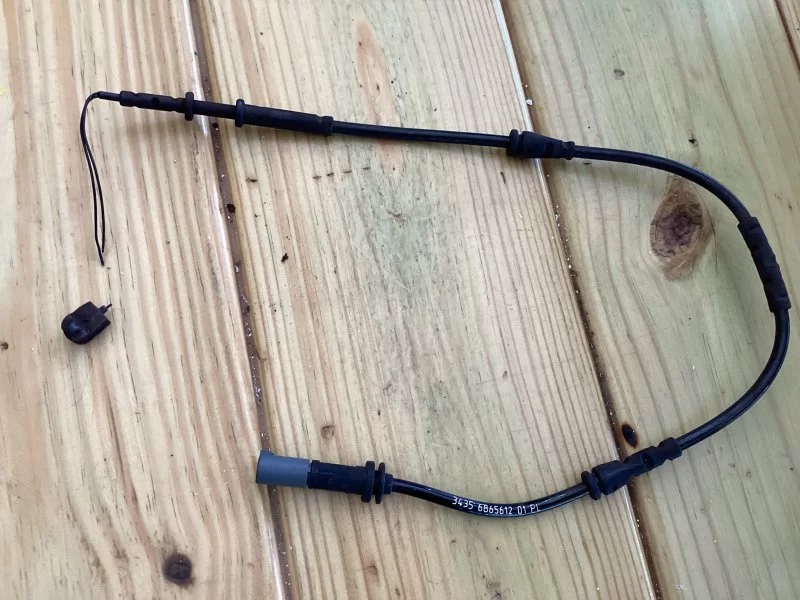

I have a same messages on brake system and dealer reset and for a week was ok but than I have a X-mas lights on dashboard second visit to dealer they replaced brake sensor on a right rear with broken tinny wire and is ok now $185 later is a pic.
and part number if you handy you replace yourself saving at list$120 I argue with dealer warranty didn’t cover 2022 SE 10000 miles

My car also had a flaky wear sensor (right rear) actually having it replaced under warranty as I type this.
I have a same messages on brake system and dealer reset and for a week was ok but than I have a X-mas lights on dashboard second visit to dealer they replaced brake sensor on a right rear with broken tinny wire and is ok now $185 later is a pic. View attachment 22453 and part number if you handy you replace yourself saving at list$120 I argue with dealer warranty didn’t cover 2022 SE 10000 miles
Thank you so much for this picture! I had a hard time finding the correct part number. I just ordered this for mine.
