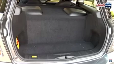

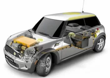

Put batteries in behind a sits as 2persons car a rear seats in Mini are useless do a survey if people will buy I’m the first buying from 32.64 KwH to 65 KWh as new design as a two seater
The return of the MINI-E!
And how much extra weight are you carrying all the time, the current SE is already 300 lbs more than the ICE version,
the new Mini EV with 54 kwh battery, dedicated ev platform, is over 400lbs heavier than the out going 32kwh model.

I have used my rear seats to house people on a few occasions and they've been fine - mind you only one >6 footer in the family and wife is 5'2. One instance was my foray to Portsmouth, NH, about 80min or so of driving. So I don't want to lose the rear seats.
