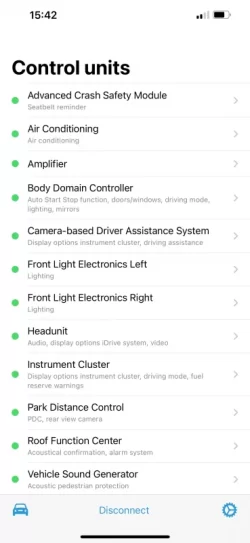

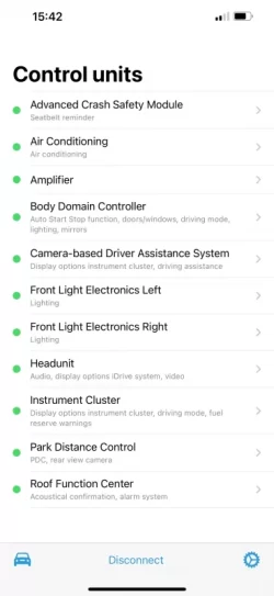

Thirdly, there is no Active Sound Design ECU listed when I connect BimmerCode to my SE, in either Mini (first photo) or I3 (second photo) modes - and the reason for that is very simple, that ECU doesn't exist on the SE, because again, it's only relevant to ICE cars.

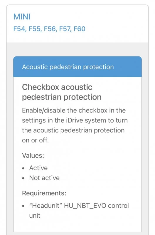

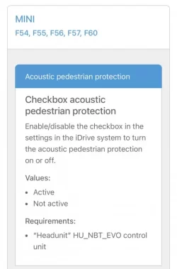

I have a question regarding the Checkbox acoustic pedestrian protection (CAPP) option. For my 23 SE, by enabling the check box, I was able to manually turn off the CAPP in the setting. However, it is turned back on every time I restart the car. Do I have to disable the CAPP option to disable APP permanently? Thanks
Here you go, although I would have expected it to be fixed by now. This worked for me.
On Aug 21, 2022, at 11:13 PM, SG Software GmbH & Co. KG <[email protected]> wrote:
Hi,
please try the i3 car selection and then there should be an option in the “Vehicle Sound Generator“ control unit that makes the car remember the last used setting.
Hi,

Thank you very much! I was able to test out the setting today. It works !!
Would you be willing to walk me through this? I got pretty good at bimmercode when I first got my car a year ago, but haven't done much since and I'd really love this option!
Soup to nuts, if you're up to it. I'd very much appreciate it!
Then navigate to the Acoustic Pedestrian Protection checkbox screen in iDrive, select the checkbox, then push and hold a hot button to memorize it. That’s it. :cool:
