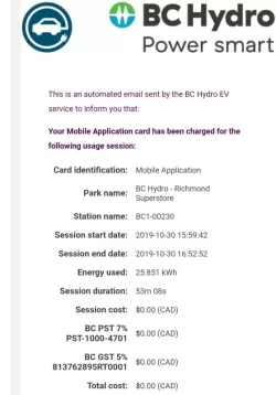

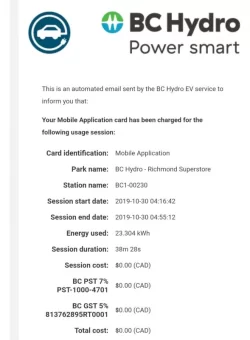

Received my 2020 Kona very recently(Saturday) and finally today I tried out the BC Hydro Fast Charging Station at Richmond's Superstore. They have 2 charging stations each with SAE Combo Connector and CHAdeMo Connector. But you can only charge 1 vehicle per Station(I thought each station could handle charging an SAE and CHAdeMO connector vehicle at same time)
I actually ended up chargin my vehicle 2times today due to the fact I had a long road trip so needed to recharge my vehicle. I have attached my readings if someone is interested. Chargin was painless although in the afternoon wait time was around 20min for a charging spot.

Obviously a low SOC when you began in the am (my guess is <30%) for the same kWh delivered later at a higher SOC (20 minute difference for same approx accumulation). Not sure what SOC you completed the session upon return, but the rate substantially drops after 74% ish .
