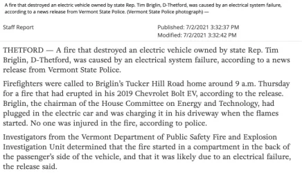

Just saw that there's a recent Bolt fire, 2nd July, a Vermont USA owner. I left out the photo as it's unnecessary. It not mentioned if this 2019 was an "affected" example, and if so was the software fix applied.

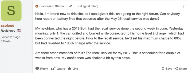

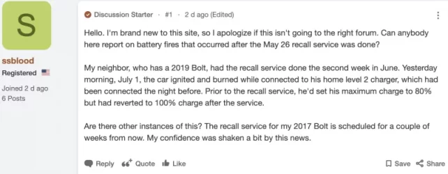

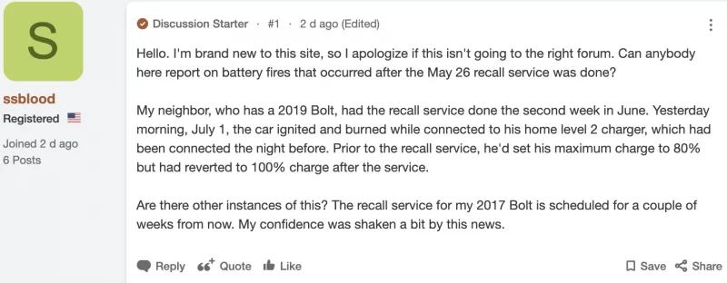

I'm reluctant to get too far off topic but it's pertinent to the concern about whether software fixes are adequate. I found more info on that Bolt fire I mentioned above, 1st July apparently. This topic was started on ChevyBolt.org which I follow even though I've never seen a Bolt :). The service referred to is the "fix" that Chevrolet released as the solution to the defective batteries.

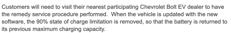

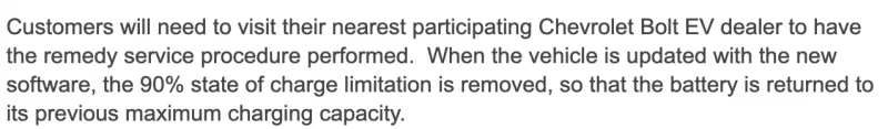

Just out of curiosity, if you know, was he supposed to be able to return to 100% charge after the software update?
Yes, definitely. This is from the recall site I linked above.
Discouraging for the efficacy of a software solution.
I also find it odd that Canada and the U.S. recommend 80% max. charge while the rest of the world (I think) has been told 90% - including Bolt owners. Makes it seems like it's just guessing.
