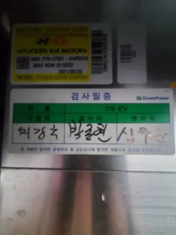

Hi,
Today my battery was replaced. I asked about the warranty and it doesn't change 8 years from the day you got the car.
They also told me that the battery cooling liquid was replaced.

Congratulations. So a battery manufactured in Asia on May 20th is installed in Quebec in mid-August. Seems fairly quick given shipping.
