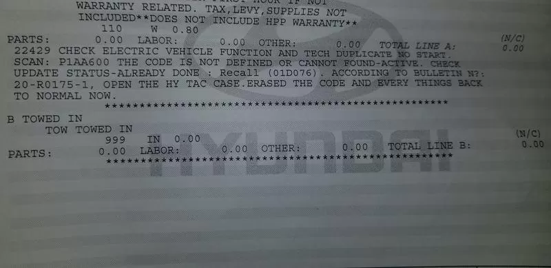

Picked up the car, at least they washed it for me, nice. I spoke with the service advisor and he sheepishly admitted that I likely will be back, nice.
Anyways the paperwork gives a little more details. The BMS code it threw was P1AA600 which translates to " the code is not defined or cannot find active" Very helpful, lol.

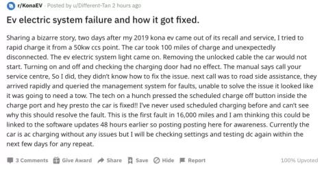

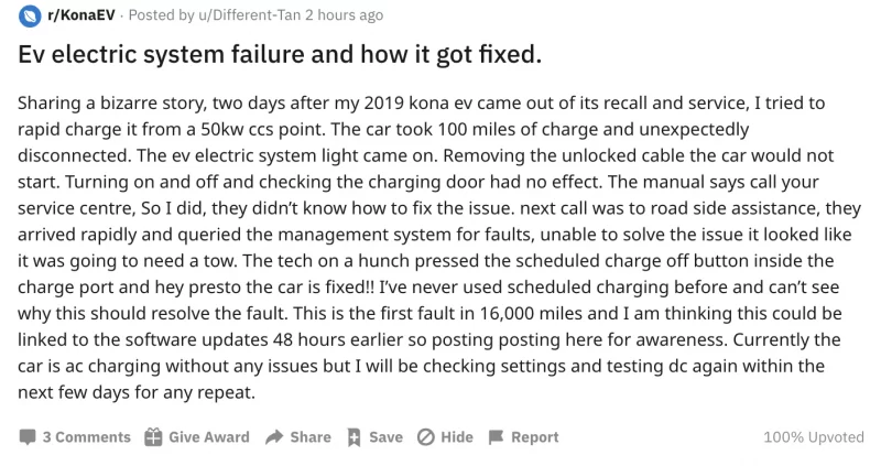

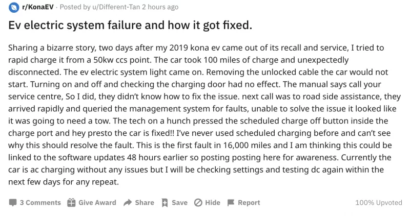

Just thought I'd pass this on from Reddit:
Interesting, but in my case I was not charging or plugged in. It threw the code either before or while I pressed the power on button. Its rubbish nonetheless as I am kind of worried about getting bricked on my usual 2 hour drive out of town for work. I can get the car towed from wherever but because of COVID restrictions I can not ride in the tow truck I would have to try and find my own way home, great.

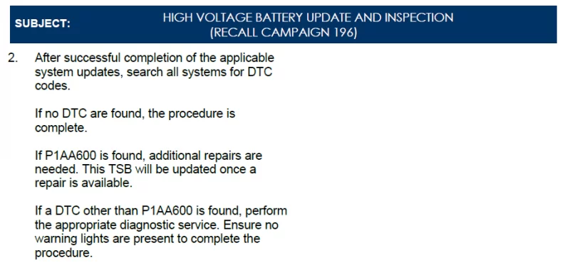

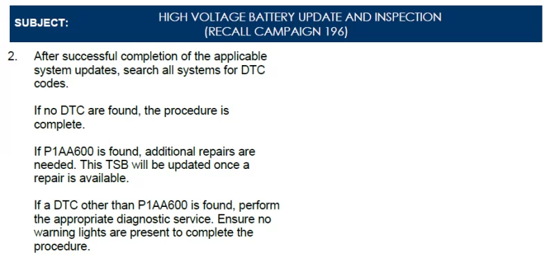

Well from the TSB:-
Hmm, there is that.
