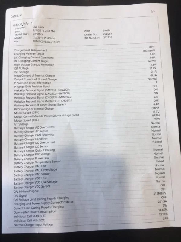

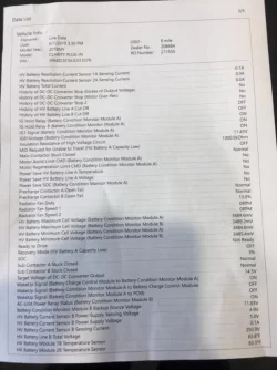

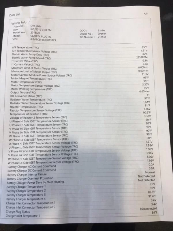

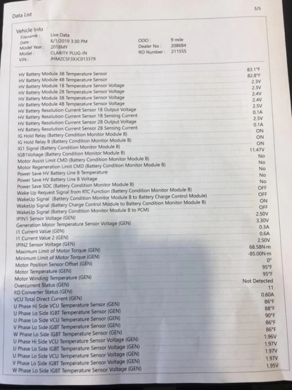

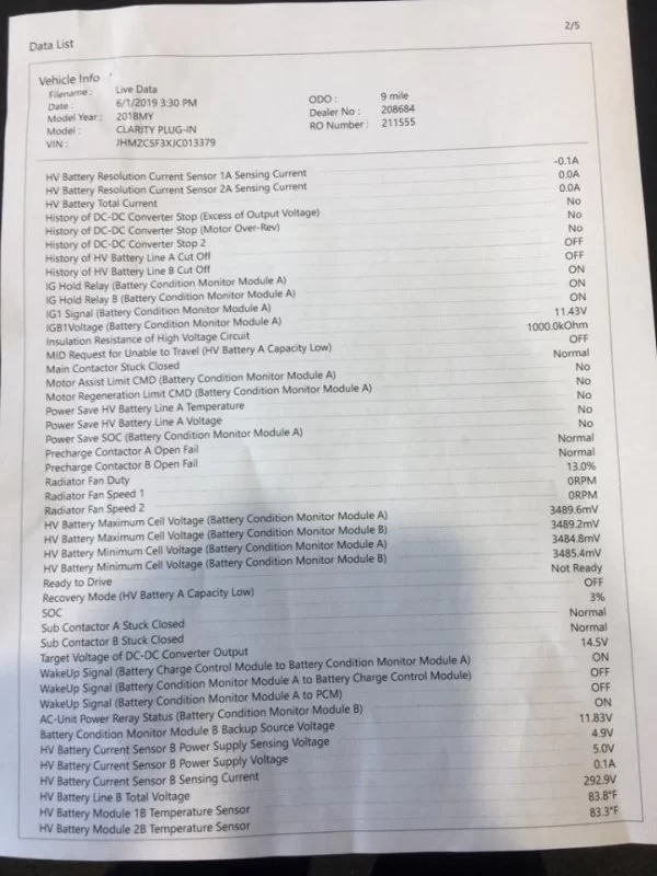

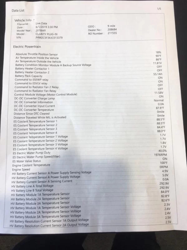

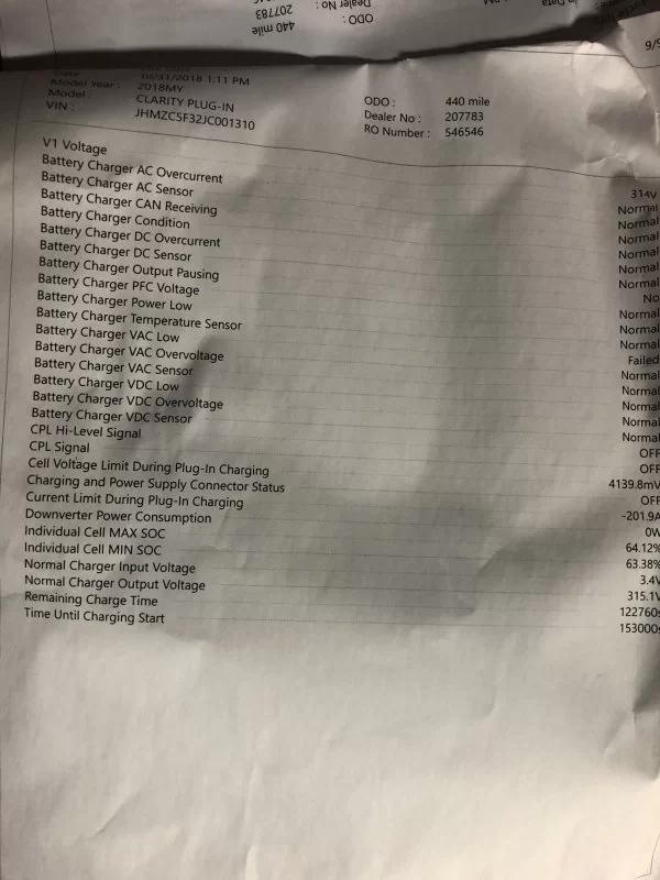

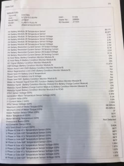

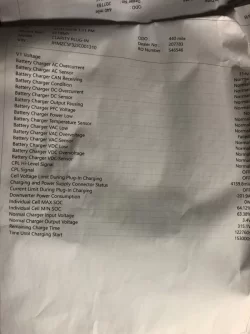

At the suggestion of the good people on this forum, I had the dealership run a battery capacity test for an unsold Clarity that was manufactured in May 2018. They just sent the results and I was surprised at how extensive they appear to be. I thought I'd share them in case they were of interest to anyone. Also, one thing that jumped out at first glance was the "Failed" on an item on Page 5 -- exactly how concerned would you be about that? I haven't yet really delved into the report, but I'd be interested in hearing any thoughts you may like to share about it.
