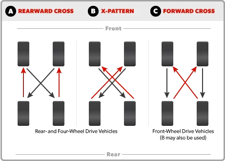

Question: do people rotate tires to get maximum life or do you all not rotate and wear out the fronts way faster ?
A long time ago I remember that the very first front wheel drive car I owned wore out the front tires way before the back ones. This never happened on any of my RWD cars since I keep them aligned and tire properly inflated. I learned my lesson then about FWD cars.
So I always rotate tires at about 6,000 miles or so. That way I’m not shopping early and wasting time getting just 2 tires more frequently than all 4 at once.
Lug nuts: 19 mm, 80 ft/lbs torque
Here’s how I do it:
Tire size 235/45R18 94V
OEM is Michelin AS Energy Saver
55,000 mile warranty, non directional
Wheel size 18 x 8J ET 50
Bolt Pattern PCD 5x114.3
36 psi
The Tire and Rim Association recommends the Forward Cross for FWD nondirectional Tires and rims

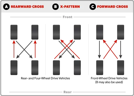

Here’s how I do it:
36 psi

Yes, we’re all going to find out how long these whiz-bang low rolling resistance tire are going to last. With only a 55,000 mile tread life warranty and all the reports on the tire forums, I’m not optimistic. There has to be some trade off in wear, handling, noise, and grip to get the design and materials such that it gives us those precious few extra miles of range.
For some reason this diagram for the Forward Cross Rotation did not embed itself on my first post. Here it is:

Fortunately, the OEM Clarity tires are not unidirectional so the Forward Cross will work. The Nokian Hakkapeliitta (I love typing that name) snow tires we have are unidirectional, so none of those patterns will work for them. These snow tires will have to stay on the same side of the car and just swap ends next winter. I not only appreciate the safety and mobility provided by our snow tires, but also how they're extending the lifespan of the OEM tires, which are now relaxing in our basement.

Maybe our definition of "unidirectional" isn't the same? I'd call the Clarity's OEM tires "omnidirectional," if that was a word.
Whoops, my bad, and Mea culpa!
Can I blame this on the closed head injury from the motorcycle wreck? My son accuses me of using it like a get out of jail free card.
I wrote “non-directional” which is of course the same as your “not unidirectional” for the OEMs. Sorry, I just couldn’t keep up and read it as bass-ackwards.
