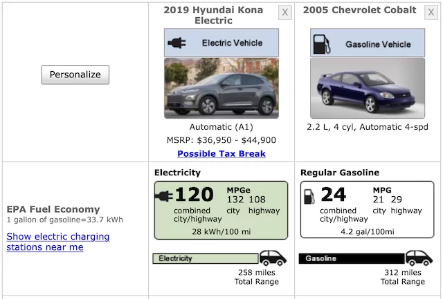

Let us consider Hyundai Kona EV 2019 and Pontiac Pursuit 2005.
I tried to find the USA equivalent:
Close enough?

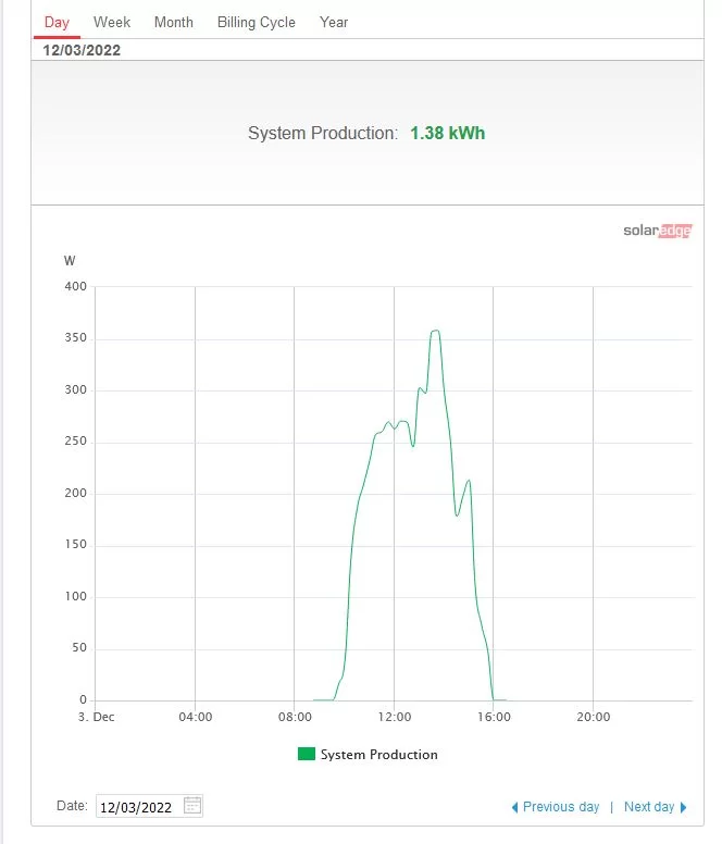

Last year my array was buried under 18 inches of snow (blizzard) and I lost 5 weeks straight of PV production. It would snow intermittently and then melt, and then snow more over those 5 weeks. It won't be an issue if you are near freezing 32F temps, but it's a different story at -25F. There was a long-term study done for clearing snow vs not clearing snow (multiple roof pitches) resulting in an overall 3% energy loss.
It gets tricky with voltage and bypass diodes when it comes to snow coverage. If you had "full cut" (square) PV cells, when the bottom half is shaded the production is 0W. Half-cut PV cells in landscape orientation also suffer significant losses when the bypass diodes activate.
Yesterday a 12.4kW south facing system produced a whopping 1.38kWh.
