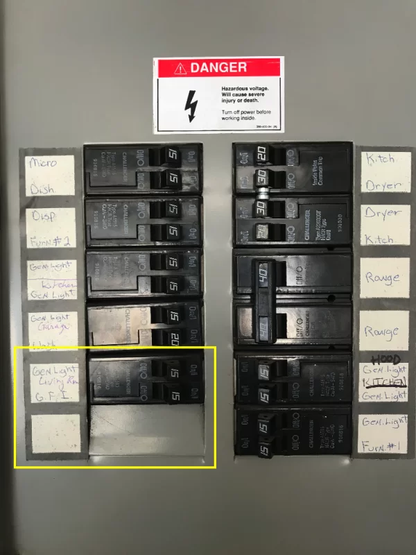

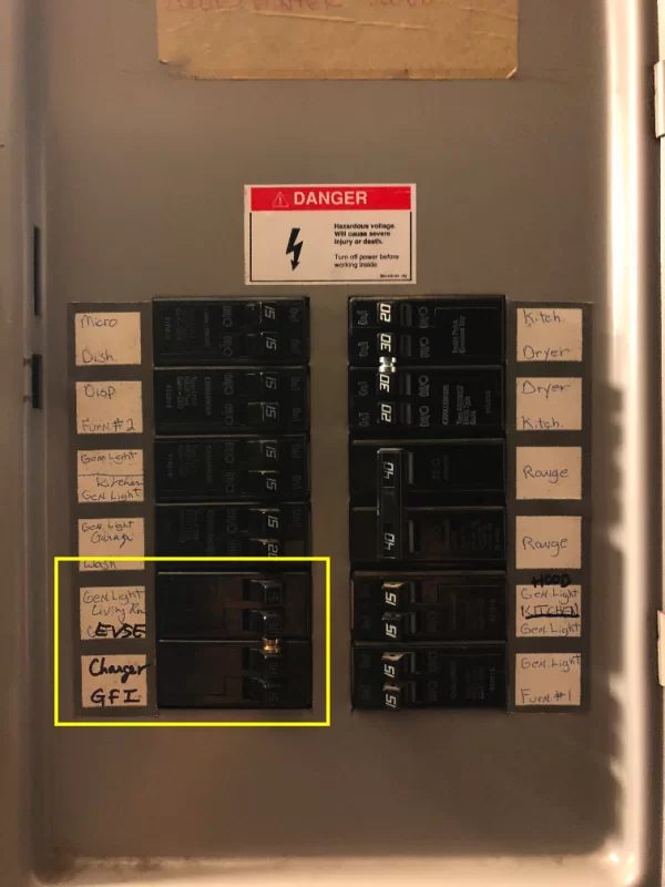

Attaching pictures of my "before" and "after" breaker panel for reference.
Before:
After:
I added the new tandem breaker by myself... total cost was under $100.
When I looked at your breaker panels... I think there are way too many dedicated breakers for very low-current circuits. For example, there are separate breakers for outlets and lights in the same room. I guess this is good, if the breaker for the outlets is tripped, the lights are still on... :) With energy-efficient and LED lights nowadays, these lights barely draw any current on the circuit.
If you look at the breaker panel for my house, built in 1992, most rooms have only one breaker for both lights and outlets. The only exception is the dedicated breaker for all GFI outlets in the bathrooms. I don't have sub-panel, just a single panel for the entire 2-level house.
If I am you, I may explore the option to combine 2 low-current circuits into one breaker to free up a space. If you can do this for 4 circuits, then you can free up two slots for a new breaker. Check with the electrician to see if this is possible.
Yes, this is exactly what the electrician suggested. I have a lot of breakers dedicated to "lights" in various parts of the house. He told me that if I were to replace all of the bulbs with LEDs then I could put all of those lights on one breaker (or two) instead of 4. In this way he could clear up some room in the panel to install a new 40 amp breaker for the evse. He will go with 6 gauge wire, run it up into the attic, across the attic and then down into the garage. I have not received a quote yet but the last person who gave me a $3200 estimate told me that he would have to replace the panel entirely. Hopefully, this is now much easier and the quote should be substantially less.

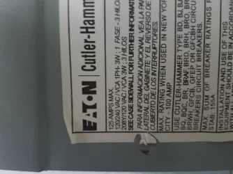

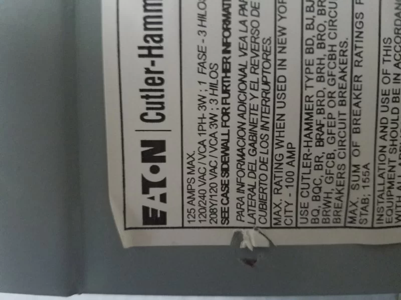

Found it....the Panel is rated for 125 amps. Should be good to go......
No! That is likewise not the answer.
Just because the panel is rated for 125 amps does not mean it has 125 amp service feeding it. Maybe. More likely it is 100. But it could even be as low as 60 for all we know. I once lived in a home wih 60 amp service from the utility. And I currently own a 125 amp sub panel IDENTICAL to yours which I installed in my basement remodel....but it only has 50 amp breaker service feeding it, with 8 gauge THHN. That is all my basement needs but I could never put a car charger on that panel in my home without first upgrading the service to it. You might be in a similar situation as you still do not know your capacity.
I mentioned earlier that somewhere is a breaker protecting the wiring that enters your panel. The rating of this breaker is what you seek. Alternately the wire gauge of the main wire coming into your panel will give a strong clue if you can determine the wire gauge. You would be wise to ask these questions of an electrician before proceeding...or st least a maintenance person for your HOA if here is one? Someone who knows how your your townhomes are wired.
