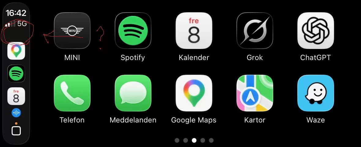

In our Mini I cannot see the battery status of my iPhone (air) in the Mini screen with Apple Carplay. Very irritating to not see the phones SoC, and if its charging or not.

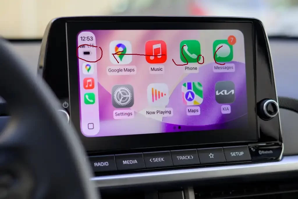

I can see that other iPhones can show it in other cars screens with Apple Carplay:
Is this a limitation in the F56 Carplay implementation, or is it a setting in the Mini or in the iPhone that I have missed?
How does the Carplay screen look for others here in your F56 Minis (please post example)?

That's the CarPlay display, right? So it should show up. Do you have the latest iOS 26.5.1 update installed? It specifically fixes a charging issue for iPhone 17 and iPhone Air.
I think that blue icon below the calendar icon is causing the phone battery indicator to disappear. The blue icon seems to be Siri voice control; try turning that off in Settings to see if the battery icon returns.

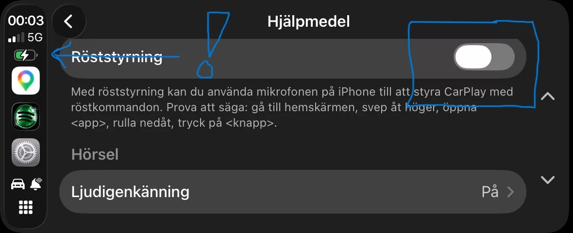

Yes, that was it! I turned off Siri voice control via iPhone microphone in the Carplay settings as you suggested. Now I can see the battery status, including if charging or not, of my iPhone in the Mini display with Carplay active. Perfect.
Thanks!
Sorry for being in Swedish, but here is the setting in Carplay (if anyone else have the same problem and finds this thread in the future):
