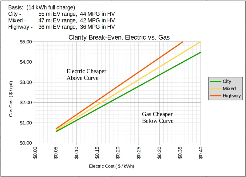

In my opinion, the generic analysis (graph that shows $2.00 per gallon is roughly equal to $0.15 per kWh) is all you need to do this simple trade. If you try to be any more 'exact' than this, you may be engaging in "Analysis Paralysis". Trying to save every possible penny is a false economy particularly because secondary effects like extra wear & tear on the engine with gas kick in and cloud the precise answer anyway.
Honda claims 42 mpg. I usually get closer to 50. Take 45 as a pessimistic average guess. 45 miles is close to a pessimistic electric-only range, too. Your easy napkin-calculation is to divide the price of a gallon of gas by the 17 kWh of a full charge.

Just one correction -- the battery pack may be 17 kWh, but the car doesn't allow all of that to be used. Driving to 0 EV then fully charging for another (estimated) 45 EV miles typically takes 14-15 kWh from what I and others have measured. So your breakeven power cost is more like 11.2 - 12 cents/kWh.

OK, thinking about this some more, and using some of the experience conveyed by @Landshark , here is an attempt to incorporate driving style into the break-even analysis...
The global assumptions are these:
1. A full charge is 14 kWh (nominal vehicle buffering)
2. Nominal temperatures (no heat, A/C impact would be small)
Three conditions are shown with these assumptions:
City - EV range 55, HV mileage 44 mpg
Mixed - EV range 47, HV mileage 42 mpg
Highway - EV range 36, HV mileage 36 mpg (70-80 mph). 55-60 mph would be more like 'Mixed'
Here is the resulting plot:
