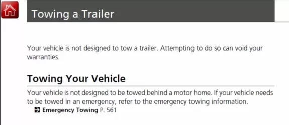

Page 375 of the owner's manual...
Of course, Honda would say this... yet every tiny car sold in Europe has a trailer hitch, and Europeans pull trailers. So, my Honda Clarity with 212 HP cannot pull anything?
That’s kinda hard to believe...

There is no towing capacity provided by Honda for the car.
There is no Gross Combined Vehicle Weight Rating, which would indicate the maximum permissible weight for the vehicle and a trailer.
Towing a trailer may void your warranty.
Can the car do it? Your guess is as good as mine. My 23hp riding lawn mower can tow a trailer. It is rated to do so and I do it on private property.
Can the electric motors and the gerbil powered engine handle towing an additional 600-1200lbs? Will the brakes be able to stop the load? Are you going to install a harness and install trailer brakes? Is the teardrop trailer equipped with brakes?
Believe it or not, the car isn’t rated to tow. If you want to tow a trailer you should have done your due diligence and purchased a vehicle that is rated and approved by the manufacturer to tow a trailer.

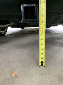

A real world answer that I read. Clarity owner put a hitch on for a bike rack and was uncomfortable enough with the low ground clearance to get an adapter to put the rack higher up. A loaded Clarity has a little over 4" ground clearance.
The bottom of the hitch is at 9”. That won’t cause issues with ground clearance. Caution will be required when transitioning from a parking lot or driveway onto a street with a bike rack, or similar rack extending from the vehicle.
