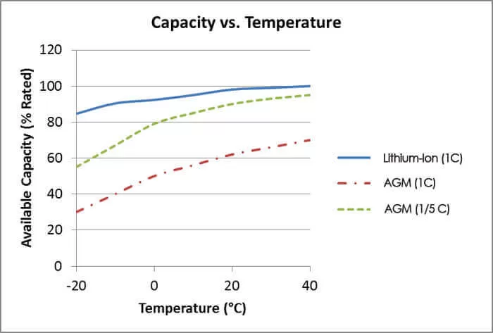

...as the battery warms, there are short charging sessions that add charge to the battery. It is as if the battery voltage actually goes down as the cells warm up allowing more charge into the battery. There are at least 5, full scale, charging events with the warming load.
Li-ion battery cell capacity is dependent on temperature. So, the higher the temperature, the higher the capacity. I don't know if that's why the BMS charges the battery in bursts as it warms, but at least it's capable of holding a greater maximum charge. What you don't want to do, however, is charge it to 100% or near 100% when it will be cooling down afterward. That results in overcharging... which, from what I've read, can lead to permanent damage (and reduction in capacity) to the pack.
Source of the graph above: https://www.powertechsystems.eu/home/tech-corner/lithium-ion-battery-advantages/
