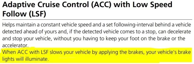

When the acc slows down a car, do the brake lights go on? Does the driver get a warning light first!
According to the manual:
"When ACC with LSF slows your vehicle by applying the brakes, your vehicle's brake
lights will illuminate."
But how would you know if it is braking or just slowing down? I can't imagine that ACC activates the brake lights anytime it slows down even slightly, but who knows what the threshold is for the amount of slowing that will activate the brake lights. As I mentioned in another thread I think all cars not just Clarity that can automatically activate the brake lights should have an indicator on the dash telling you whenever that happens. Brake lights are a signal to other drivers and here we have no clue when or if our cars are sending a signal to other drivers.
