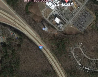

We've got over 30k miles on our Clarity and I know exactly the situation you are referring to! It seems worse to me when the highway is is turning to the left with a right exit so that the Clarity is somewhat pointing towards the car that has exited and is decelerating. This is one of the exits where I have had the same situation.

I have experienced this as well! Same exact scenario that happens every day while picking up my kid. Albeit I am usually at 40-50 due to traffic. I have concluded this happens when the exit runs too close to freeway almost like a next lane and current lane turns. The car seems to misjudge it.
Edit: I saw the example posted above...YES!!!
