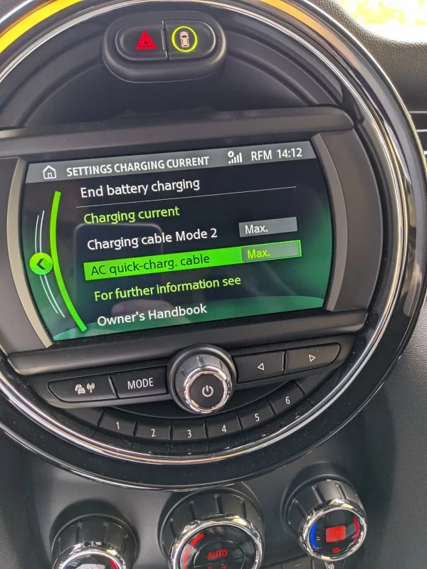

Hello guys.
Anyone knows what this setting does?
My mini - - plan charging/climate control - - settings charging current - - ac quick charge cable
Thanks.

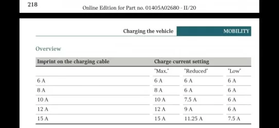

That's what they call level 1 charging. There's another setting for that - charging cable mode 2 - which has those values =l(max, reduced and low). The setting I'm asking for only options (max and min):

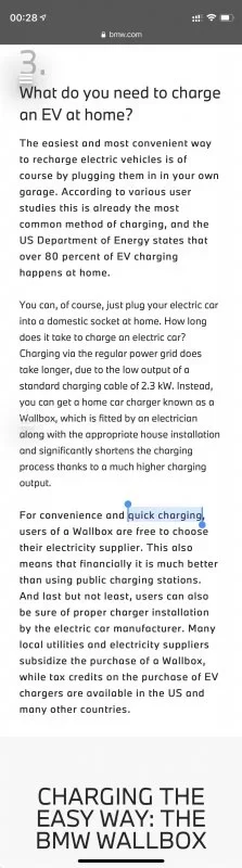

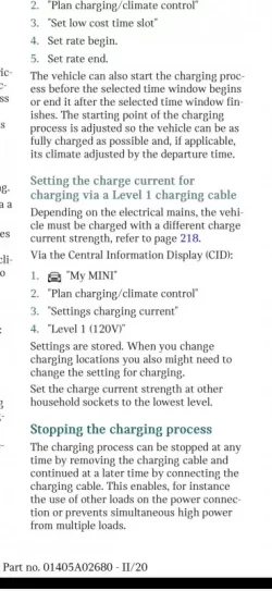

Alright Luis. We’re going to figure this out. The first screenshot is from the Motorer’s Guide. I think it just means AC charging with a 240V J1772 connector.
The second screenshot is off BMW’s site and it speaks to their wall box which is just that (240V/J1772). No mention to what max and min mean though. What do you think?
Edits:
Other BMWs

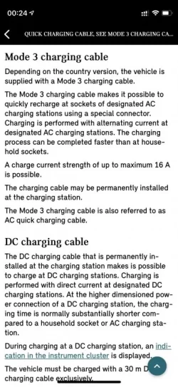

This article on the 2020 MINI makes me think “low” would be 3.8 kW and “high” 7.4 kW.
Hello guys,
I think you're close. According to a fellow i3 owner, that setting will only influence charging from a single phase box (between 3.6 and 7.2, if the box allows it). Since I was testing it on a 3-phase ac charger, it was not doing anything...
