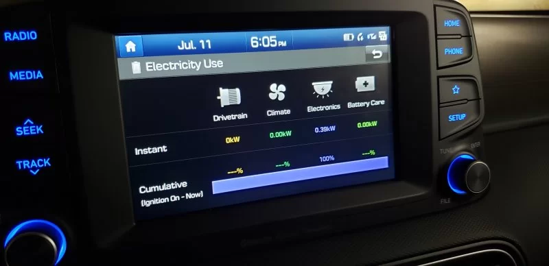

Try using the electricity use menu- (under battery care) - the power regenerated is accurately displayed under the drivetrain icon. Here is a screenshot from a 2019 model using the smaller screen, the same menu is available in the 10.25" screen as well:
index.php
I'm jealous, I don't have an "Electricity Use" screen in my 2021 Preferred model. And I have spent far too much time exploring the menus. Maybe a secret branch?:-)
