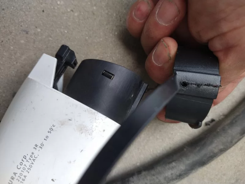

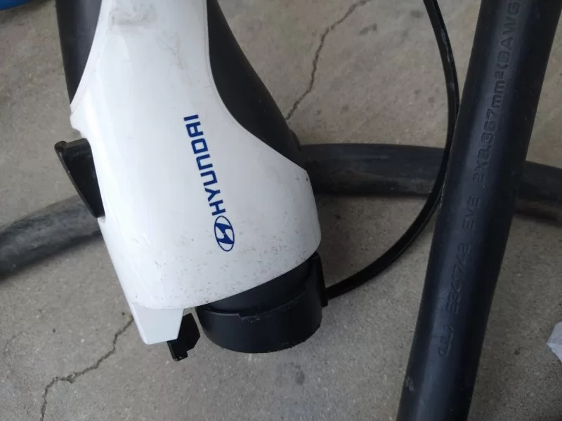

Just a quick note, I did the light bulb test and confirmed the OEM Hyundai Kona charger works at 240V and have been using mine with a homemade adapter cord to use it at 240V, twice as fast and simple!
But the dust cap is annoyingly tight to take off so I drilled a 1/8" hole from the inside view near the end and them hacksawed a slot so the cap can flex and still keep the dust out when capped. Now it slides on and off much easier and with the stress relief 1/8" hole the slot should not crack until it gets really sun aged.
The slot is on the side next to the retainer strap, which is most often facing down so its good for moisture drainage also.

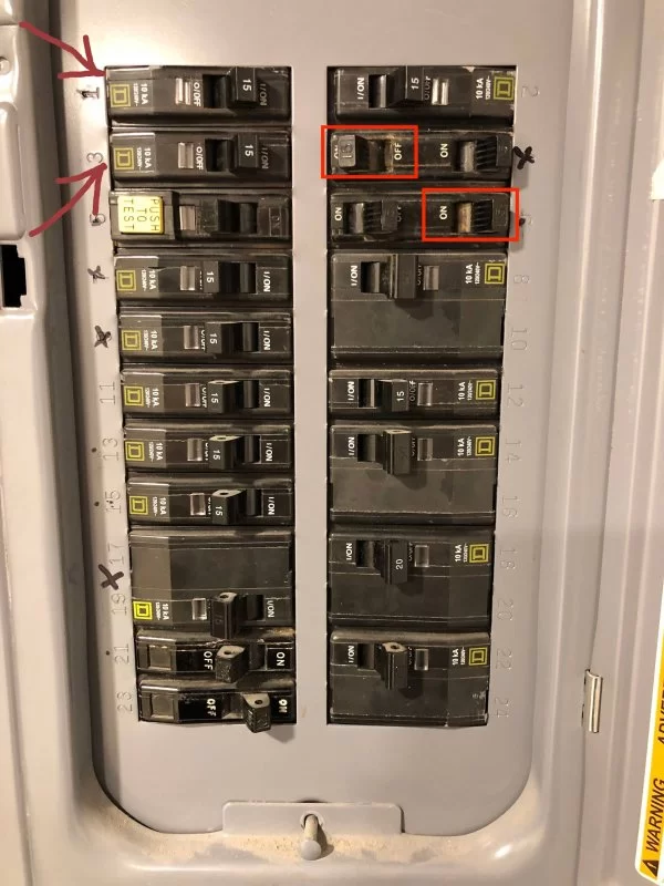

So if I were to do what you did, I would join the circuits from breaker # 1 and breaker # 3 as in the picture? This is not my actual panel, it's a pic I got from Google.
Correct. If we call either side of the 240V phase "A" and "B" respectively, then it breaks down as:
1A 3B 5A 7B 9A 11B...
and
2A 4B 6A 8B 10A 12B...
This is done so that no matter where you install a proper 2-pole breaker (there are 4 of them in that photo), you will always pick up both legs and get 240V.
