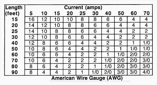

Indeed your wire gauge goes thicker with the length you need to deliver 40A or 50A. Here is a table with distance
taken from this site: https://4.bp.blogspot.com/-1Q6U18oMtu8/VLAAqXFBGGI/AAAAAAAAICU/SXXLVBmaxX4/s1600
