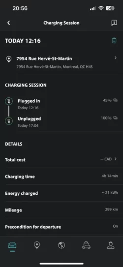

Hi,
Thank you all for your response.
Not sure if I was Clear.
I live in New York.
The question I have is not the range when driving after a full charge.
At a 100% charge it is only showing (last night charge ) at 83 miles. (refer to attached screen shot)
Why is it not showing at 100% charge at least 110 miles?
Totally understand that the range will diminish once I start to drive in cold weather and the combination of winter tires.
Appreciate your guidance. Anyone have a same situation? Not sure if this is what is expected?

I, like many experienced SE drivers, mostly ignore the GOM (focusing on battery % instead), but I do notice after charging it starts out with fewer miles than the EPA's 110-mile number in cold weather. The SE knows how cold it is and perhaps it assumes I'm going to use the range-robbing heater.

The GOM takes into account the temperature where the car is located as well as recent performance. You can test this if you don’t drive by watching the estimated range change as the temperature changes.
