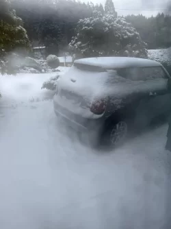

Cold snow is def better than the 37 cm of heavy slop we got this weekend. After making it this far with a bare driveway, my plowing contractor’s PTO blower basically managed to compact a lot of it into an eight inch layer of hard-pack.

That's okay, it's just going to -25F overnight. I just got back from using an electric leaf blower to clear the snow.

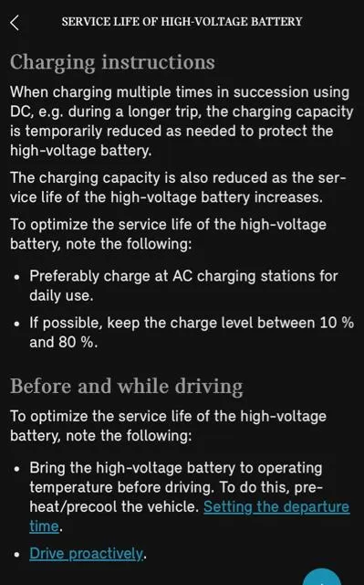

BMW are not saying anywhere not to charge to 100%, just to keep the battery between 10 and 80%? If they wanted to make an 80% charge achievable they would have given us software to enable that?!
I interpret the guidance to mean: feel free to charge to 100% but then use the car immediately - ie don’t charge it fully and leave it sitting around for days at 100%. By all means charge it again to 100% but use it immediately again, else don’t charge it but use the car and keep the battery within the 10-80% range, which unless you’re doing lots of miles seems achievable.

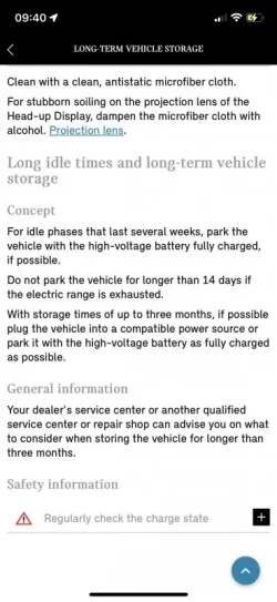

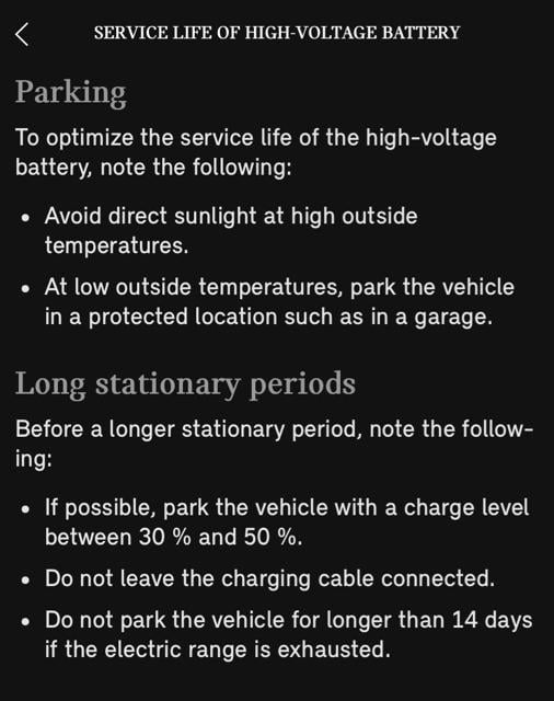

That runs counter to the guidance in the manual for long-term storage (I have a 2021 SE).

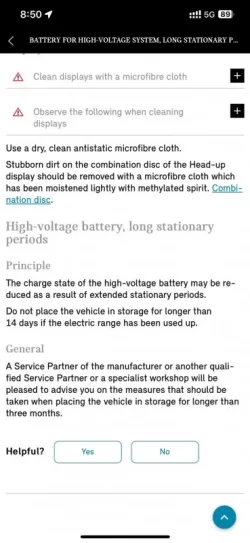

Our manual is even more vague
How weird it is New Zealand MINI won't provide any guidance on long-term storage. "Go ask someone" isn't much help. Also, "Projection lens" versus "Combination disc" seems like really divergent language for the head-up display. Quite the cultural difference.

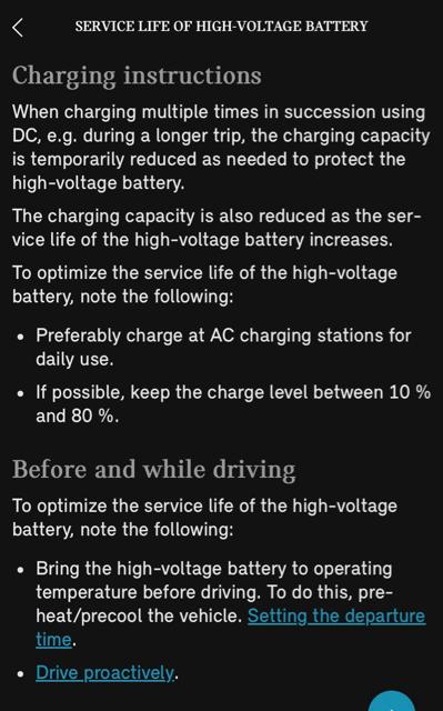

That’s my interpretation as well based on what is in the 2022 manual
And 2022 long term storage guidance is bit different than 2021
I know right. I am confident that our 2021 (2022 model in the US) came from Oxford. The only difference from the US would be the steering wheel on the right side for us; yet the manuals are entirely different.
