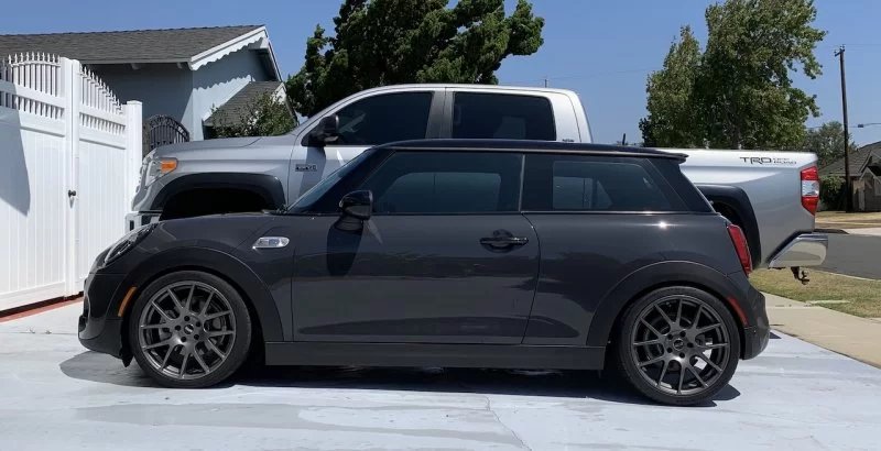

Btw what is the offset of your wheel?
Oh yeah... Never from a dig! Wheel specs are:
NM Engineering Rse12
Offset: +40 mm
Tire size is 215/40R18
The wheels and tires I had on my 2019 Cooper S, I was worried about how they would fit with the SE's extended flare but they are fine. Here was my 2019 Cooper S. The funny thing is, other than the newer OS on the infotainment, and the SE being electric, it feels very at home on the new car. Both cars are Iconic trims. Taught my 13 year old son to drive (first in my truck, then to the manual trans Mini) and he said the SE is boring in comparison. I think I am doing better without a manual than he is.

Thanks! They look great on both cars honestly. I'm probably not getting wheels anytime soon, but I'm thinking of lowering and spacers for the time being. Just looks a bit anemic in stock form...
You will definitely need spacers if you plan on using your stock wheels. Here is a pic of mine before I had the TPMS sensors swapped over. See how inset the rears are?
If you don’t care about anemic range on SE your bigger and wider tires are going to make a range worse and in IL with snow lowering a SE which is low from a beginning don’t make much sense.
I lost about 10 miles or range at best guess. For me, it does not matter since the SE is not my only vehicle. But yes, if would definitely hurt if it was my only car. I also live in Southern California, the car will never see snow or temps below 30 degrees F.

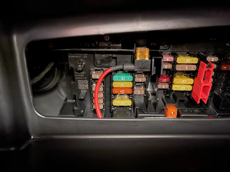

I don't think that was the one but I will look and get back to you. It powers on with the car.
Ha! Love to hear it! But yea from a dig it's meh, 10-20 and your a cheeky monkey! Lol
NVM on my previous comment of the FUSE, was looking at the wrong one on the Fuse diagram, it seems it is position 50 the one you used, which is a 5 Amp fuse.

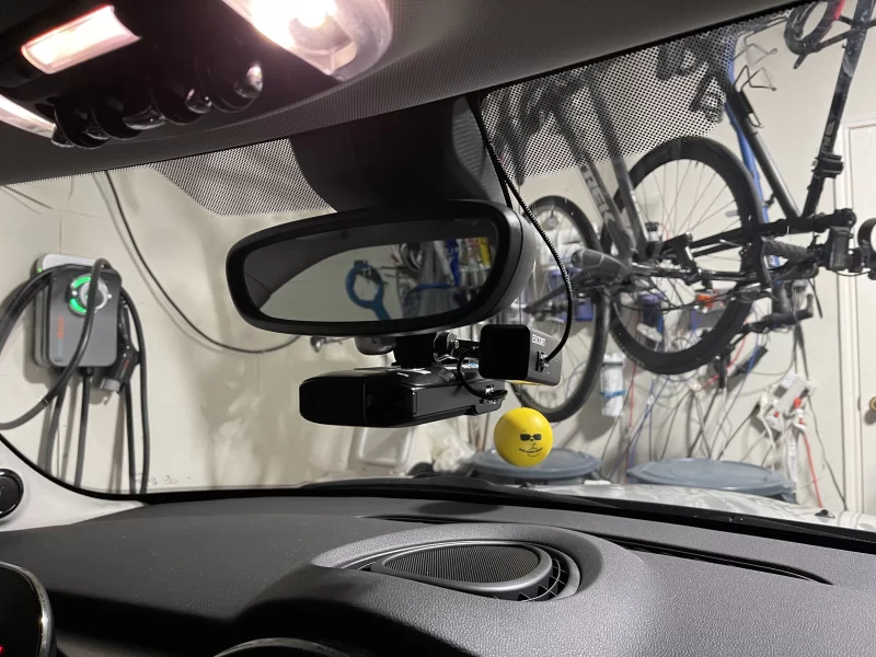

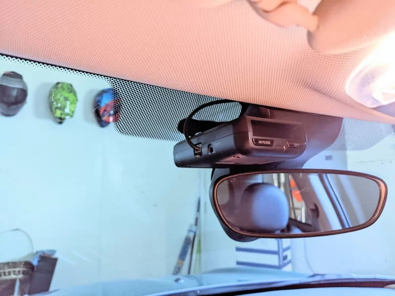

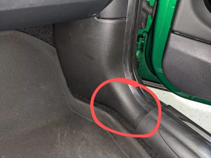

Hey sorry for the late response!
Yep routed along headliner down to side of door to into glovebox/footwell area.
There's a good grounding bolt under the carpet/door trim, so have to take those pieces off, but easy to find after that.
I hate suction cups, so I usually just use the regular mount and take off the cups, and then use 3M VHB double sided tape. Keeps it nice and tight. Just make sure to use some alcohol to clean both surfaces to make sure it bonds well.
Let me know if you need anything else!
View attachment 17762View attachment 17763View attachment 17764
I’m going to be using a 3M sticky mount for my Escort detector as well but wanted to tap the RJ11 power cable into the mirror (or other available power). Has anyone done this or know if there are available power connectors to take this at the mirror/ACC assembly?
I've used mirror taps before, I'm unsure if they make one for the SE. I would imagine there is power up there, but you would have to test the wires to find out which ones to use.

Thanks for the help, just mounted the Radar detector, I did uses mirror mount since also have a dashcamera that piggy backs for the power source, used the same ground under the carper, very easy.
