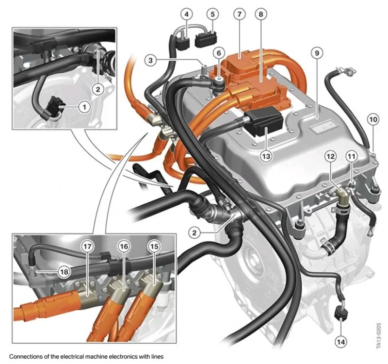

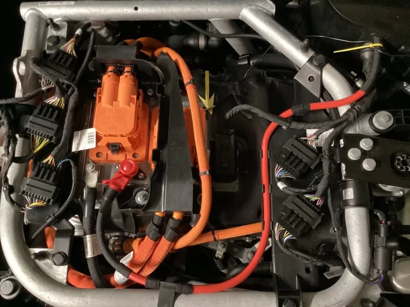

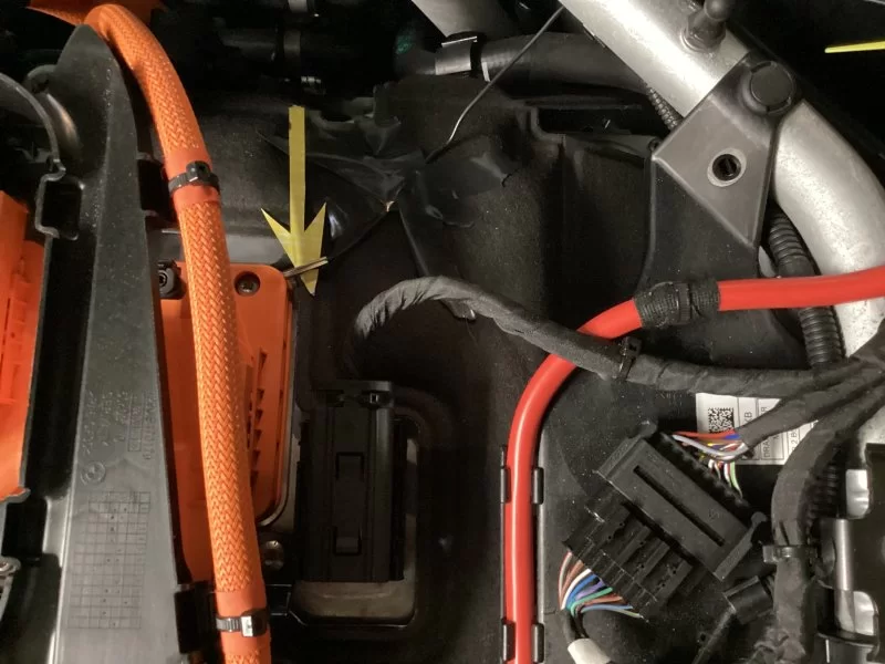

@Rexsio, the thing you are measuring is the EME. The enclosure includes the inverter, the DC/DC converter, and an ECU controlling a bunch of things like the motor parking lock. It also happens to have two internal temperature sensors and is liquid cooled (see #2 and #12 below for coolant in/out)
The outer surface of the EME enclosure will not match the temperature of the internal components and cooling the outside surface won't necessarily make the internal components cooler because they probably have a very small contact area with the enclosure (a couple of mounting screws) and will have very low heat transfer
If you really want to keep the temperatures down for the important components (motor/inverter/battery) the best thing you can do is to keep the power meter as low as possible and avoid strong regen.

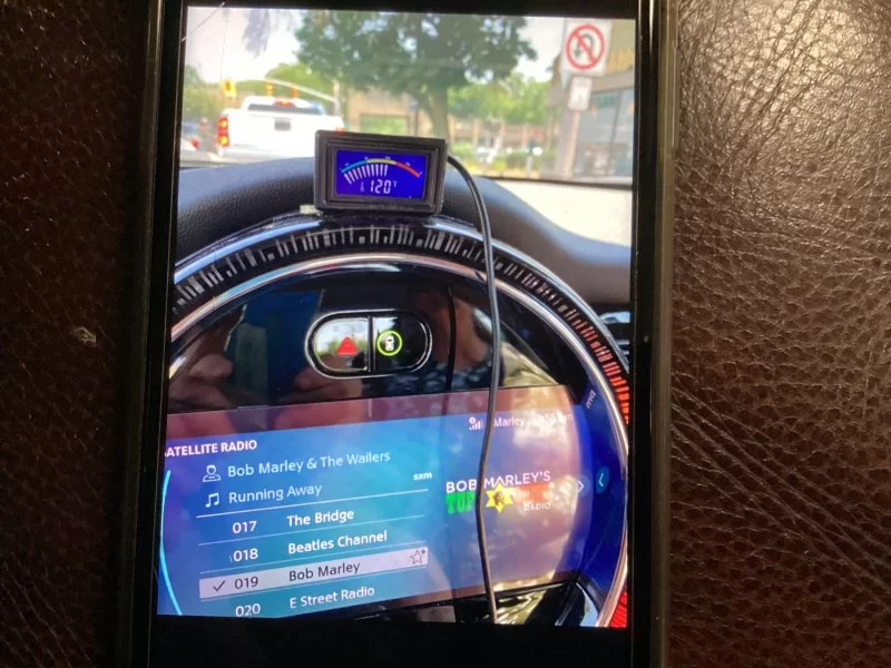

To everybody information without cover with temperatures 85-95’ I m not going above 100’ F . At all which before I was in 103-107’ all a time .Idea is to not abuse cooling system .
Today with outside temperature 97’ and short trips driving AC on 68 ‘ green setting and maximum regen plastic motor cover on shelf in my garage I set my record of 120 ‘ .On highway with speed 60 Miles/hr temperature was 93-97’ without cover.
@Carsten Haase where did you get that diagram of the cooling system?
I've posted it somewhere else but it's not easy to find things on here so here it is again.
It's technically a training document for the BMW i3 but almost all of the EV components are identical in the MINI so the info is still relevant. This is for the launch i3 so doesn't have info about the i3s motor used in the MINI (although the design should be similar)
There's also one specifically for the HVAC system, just ignore the sections related to the REX version of the i3.
I’m not able download what you send here but I own i3 for 6 years and I never measure temperature on it a motor arrangement is in back of I 3 have a bottom of a i3 was completely open to a bottom a lot of air flow there but SE motor is completely enclosed from hood to bottom enclosure. If you in hot climates just touch a silver bars holding motor you see how hot thy are .Why I’m exploring this temperatures bc I read on Motor Trend magazine in a beginning of SE how easy is to over heat SE . Obviously Bmw build bulletproof cooling system but I’m checking those temperatures for my own knowledge .Motor Trend magazine also said is a most complicated HAVC system of all EVs.I3 basically the same motor on SE is improved from i3 S heat exchange pump the same and all electronics the same from brakes or suspension 3 series . Is a Guacamole of a i3 and ACE Mini Cooper . But as cheapest EV I love a car performance and is still BMW .Today I try to reach maximum speed a speedometer show me 94 miles/ hour. Great for go cart.

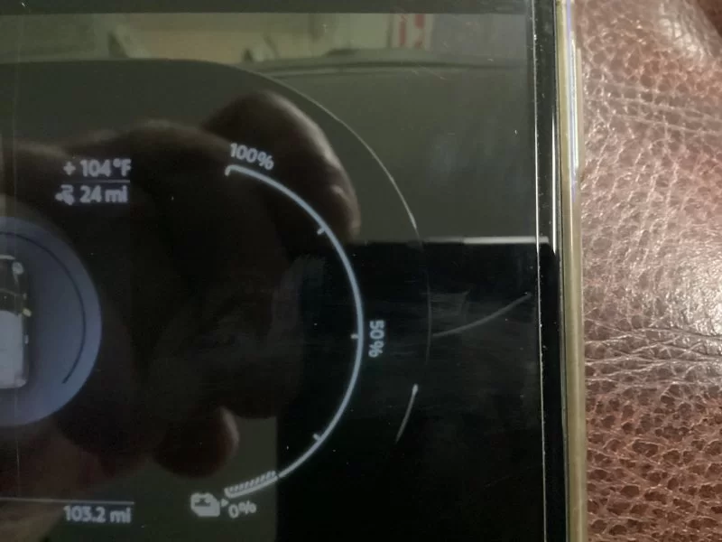

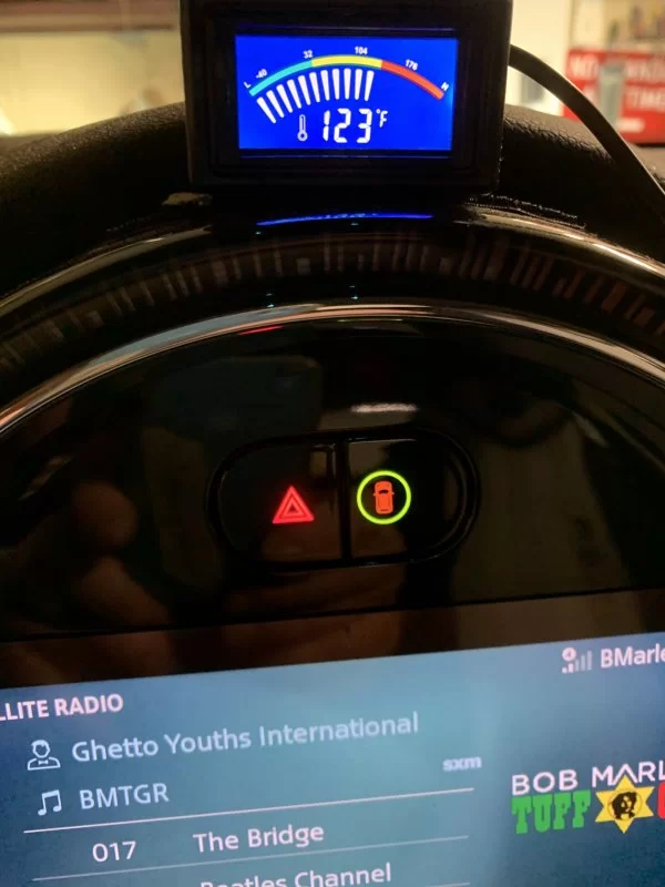

Lower temperatures are not deteriorating cables inverter and all components as fast and a cooling system is not working hard unnecessarily also 12 volt battery stay cooler and I don’t understand why they cover 12 V. Battery so tight with plastic cover .Today outside 104’ and without a cover over motor I read 123’ under a hood driving car with AC on 68’.I run an attic fan in my garage and with open hood in a car temperature went down to 100’ in 15 minutes. Garage temperature now is 80’ and like 10 hours later a motor is reaching 80’ but takes 10 hr. to reach that.My attic fan I run only when I need when I’m working there .

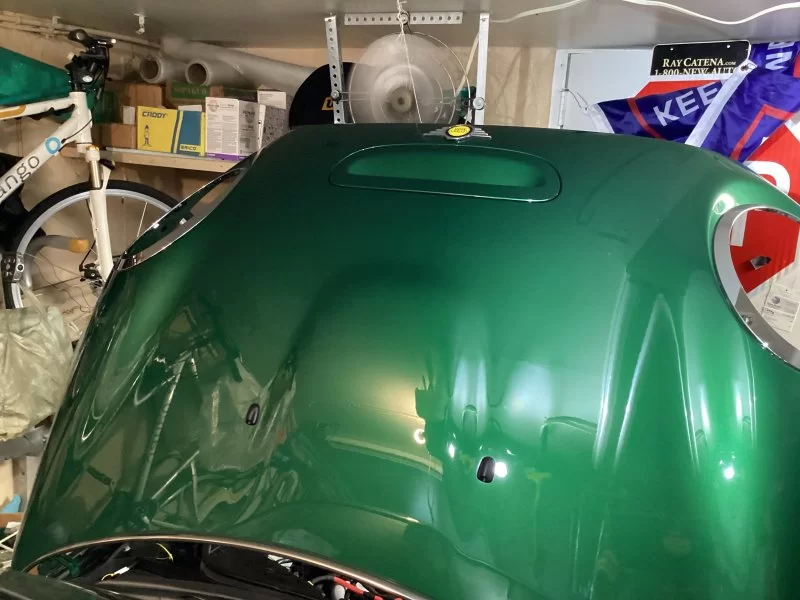

Rexio's making breakfast (but he's smart enough not to fry greasy bacon on his hood) :)

You see I don’t give a crab if SE explode tomorrow is not my first EV but for curiosity I’m measuring a temperature for $10 thermometer to keep me busy .And as you in Ann Harbor summer could be similar as NY but winter good lack if you keep that SE outdoor . I bet you have more cars as me and we don’t care about winter conditions my crab sits in 60 ‘ garage at winter and I’m polishing a bumpers .
