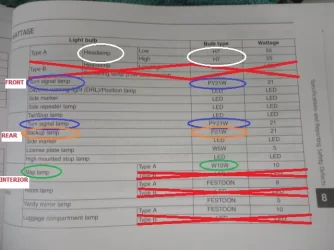

This is a shot of the actual bulb chart from the owners manual:
Any firm I contact at this point cannot tell me definitively if their 2020 bulbs will fit in my wife's 2021.
My first ask from the community: could you look at your 2018/2019/2020 bulb chart and confirm what the circled bulbs list at?
After Labor Day weekend, I'll probably remove each bulb, take some pictures and measurements and post them here for comparison/comments.
Next time I'm at the dealership, I'll see if the part numbers for the 2021 (lamp housings and bulbs) are the same for the 2020 as that will also determine what will and will not fit...unless there is a proven good online source for Hyundai parts using actual part numbers to confirm compatibility.

Hello @navguy12 ,
You could try this site - I've browsed to Kona Electric 2019 ultimate Electrical Bulbs
John.
Thanks for the links. Unfortunately, neither site can link me to 2021 parts (yet).

Your bulb wattage page is IDENTICAL to my YOM 2019 right hand drive Kona. I don't intend to change my backup or turn signal lights so I have not opened to see what type of bulb is in there. I personally think those are "safety critical" bulbs so best to stay with the factory fitted ones.
As for the map lamp, it is a standard wedge bulb that can be replaced with an equivalent LED bulb. Nevertheless, I did not change mine as I find the 10W halogen bulb is bright enough. There is also plenty of space to install a bright LED bulb if you so prefer. I did change out all my Festoon bulbs to a brighter LED ones.
Just a word of caution about LED bulb colour temperature...it varies a lot!!! You will never know how it will look until you install it.
