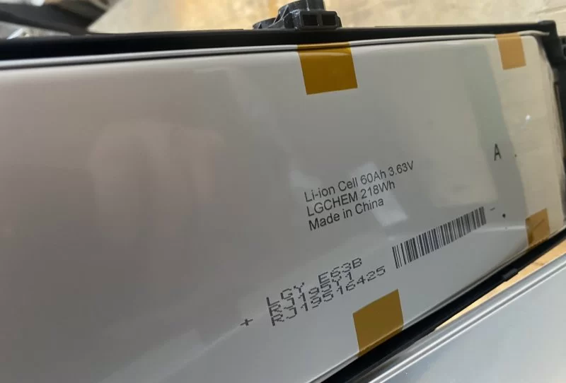

Perhaps they don't say this because they are exactly the same batteries (with minor modifications as time moves on).
Original cells (2018 - ~2020 were LG E63)
https://www.insideevsforum.com/comm...tery-and-see-real-capacity.10585/#post-124755
Replacement E66A cells were developed to replace the E63 offering more energy density with less weight and volume (slight chemistry alteration - NCM 622 (E63) to NCM 712 (E66A):
LG Chem LGX E63
- Nominal Capacity: 65,6 Ah (discharged at 21,6 A) – 64,8 Ah (discharged at 32,5 A)
- Minimum Capacity: 64,6 Ah (discharged at 21,6 A) – 63,8 Ah (discharged at 32,5 A)
- Nominal Voltage: 3,6 V
- Charging Voltage: 4,2 V
- Thickness: 11,5 mm
- Width: 125 mm
- Height: 325 mm
- Volume: 0,4671875 L
- Weight: 964,9 g
- Volumetric Energy Density: 492-505 Wh/L
- Gravimetric Energy Density: 238-245 Wh/kg
- Chemistry: NCM 622

The E66A was made to be a direct replacement for the E63 battery cell. Capacities are very similar, but dimensions and weight are lower. This battery cell is used in the battery pack of the Porsche Taycan, which doesn’t much sense. The large and flat battery pack of the Porsche Taycan could benefit from the usage of longer cells such as the E78.
