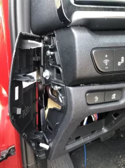

First you need to pull the crash pad switch panel out.
To do this you need to start with the door aperture trim panel, which will pop out with a trim tool or carefully with a screwdriver. It is retained by the door seal, but you can leave it tucked in IMG_1845.webp
The two screws seen here backed out need to be removed. The lower panel that contains the fuse box door can be pulled out and down without totally removing it. Then the switch panel can be pulled out, you can get some purchase with your fingers between the steering column area. If you haven't removed newer car trim, it takes a good pull but do be a bit careful
Once the switch panel is out you can see the connector on the back of the switch assembly. This is connector M26 on the wiring diagrams. There is a blue wire with a black stripe that needs to be tied into. I used these:
https://www.mcmaster.com/69515K23/
The snap onto the wire and allow a 1/4 male quick disconnect to plug onto it IMG_1843.webp
The Blue/black wire is on pin 9 of the connector. Ground is a black wire on pin 24
