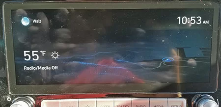

My home screen is almost blank. I can swipe right to settings, and touch the right side to go to the map. Is there anything else?

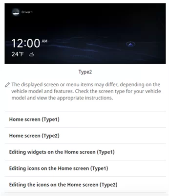

How do you set the tile on the home screen? The online owners manual has instructions for editing home screen widgets for the old version (Type1) but not this new one (Type2).
