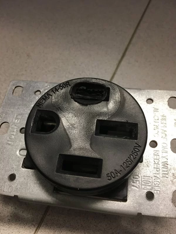

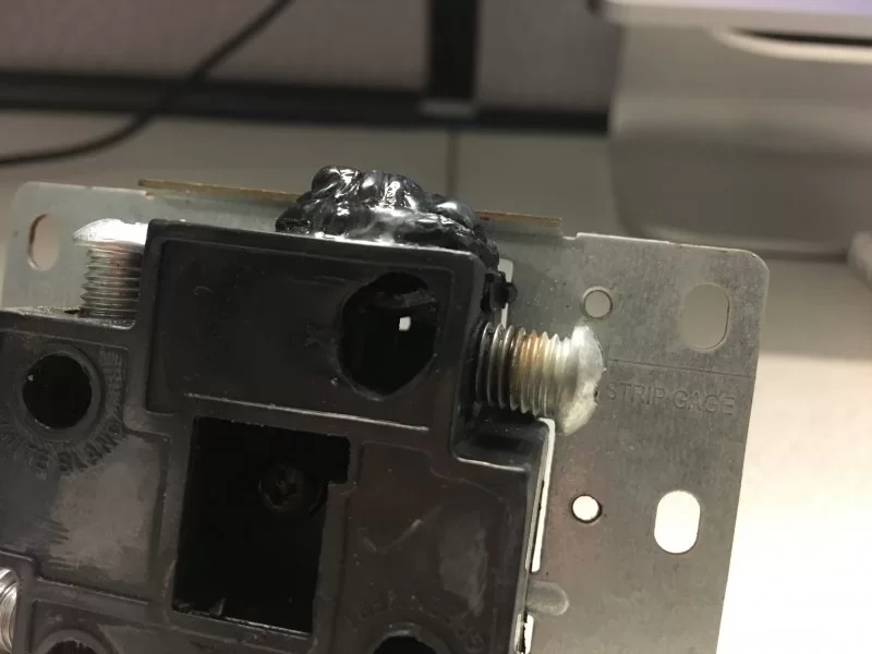

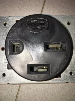

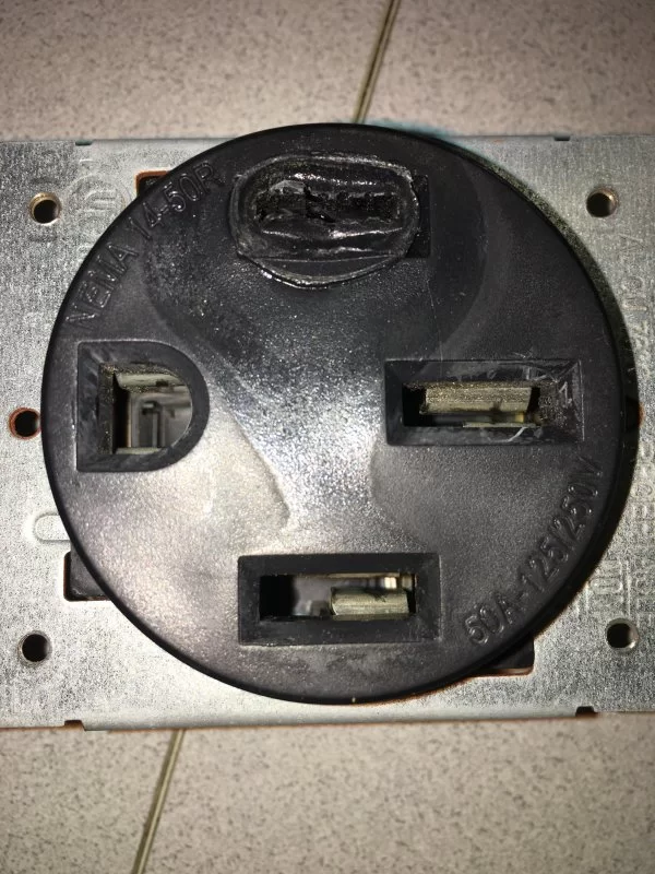

ALERT! I have made a recent discovery to where that fertilizer smell was coming from in my garage. My L2 Charging Station had been giving me fault lights that I have been able to successfully clear by turning the 50 amp breaker off and then on again. I could had also just pulled out the power plug but I have found it difficult to pull out. Well, based on the code the fault lights were giving, the Charging Station manufacturer sent me out a brand new one as they determined there was a problem happening with the unit's "contactor" which is the part that makes the thunk sound when charing starts. So when the new one arrived, I was taking down the old one off the wall, but I couldn't unplug it. So I shut off the circuit breaker and I had to really work to get it unplugged. I discovered that the outlet had partially melted!!!! So the plug was practically hot-glued into the outlet by one of it's prongs. I had an electrician replace the outlet last night, and when we pulled it out, guess what it smelled like.....like that same gassy fertilizer smell! So it would appear that the odor I had been smelling now and then was due to my outlet slowly melting! Here are some photos of the melted outlet. Now I know to check the plug and outlet once in a while and if I smell that oder again, I'll know what it is!
Was the outlet not adequate for the application, or was it faulty?
The outlet and the wiring are all to spec. A defect in the outlet is possible. However, someone just pointed out that the following could happen with high power outlets like this:
"That's called thermal avalanche. Not good but easy to prevent. You just have to right the connections after they have been warned up. If the connections are allowed to remain looser then the next time it warms up there is more resistance the connection gets even looser, more resistance, more heat ECT ECT. Thermal avalanche"
I thought this was very interesting since my electrician suspected that this could had been caused by arcing due to loose wiring.
View attachment 5862 View attachment 5863 View attachment 5864
Looks like a loose connection to me. Make sure to apply adequate torque. Probably damaged the old EVSE male connector as well.
