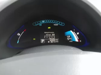

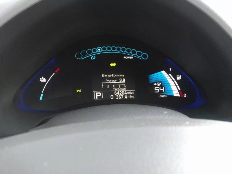

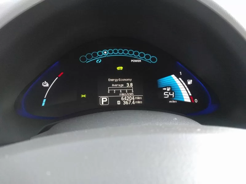

I saw my 2012 with no blue bars a few times. Last winter after Christmas we had a week with lows below 0F. Attached picture was January 2nd 2018 at -11F according to the Weather man, - 4F according to the dash (dropped to - 6F when I got on the road) . I do not have a garage. IMG_20180102_073321.webp

I saw my 2012 with no blue bars a few times. Last winter after Christmas we had a week with lows below 0F. Attached picture was January 2nd 2018 at -11F according to the Weather man, - 4F according to the dash (dropped to - 6F when I got on the road) . I do not have a garage. View attachment 3112

Quite clearly this car either doesn't have a battery heater or it wasn't working. Would the car even move in this state?
Oh yeah, she ran fine. The dash was a little slow to light up (half a second, not super slow) but no other symptoms. No turtle light on the dash to indicate reduced power. The car just WORKED. A testament to the hardiness of EVs. And I think it did have a battery heater, the temperature gauge on the 2012 was probably just calibrated differently than later years. *shrug* It's all software after all. I took a whole series of pictures and screen captures that day but sadly no LeafSpy. When I got to work (17 miles and 30 minutes later) the car said the exterior temp was 0F, the battery temp was up to 1 blue bar, and the battery gauge showed 3 bars remaining/14 miles. I charged at work.
I bought the new Leaf so I don't have to charge at work on cold days. The 2012's battery had dropped to 8 capacity bars after 72,000 miles. Maybe the cold hastened that. The ball joints were loose so the lower control arms needed to be replaced (dealer estimate $1040) and she needed new summer tires in the spring. Rather than sink money into that it was time for new and improved. Such an improvement!
