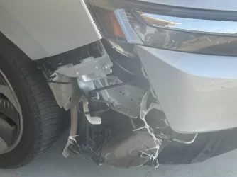

I damaged the car a couple years ago. I high-planed in mountain driving, crunched the front end slightly, causing the DRL covers to slightly split from the frame. Most damage was to the right side. I secured the small panel with zip ties, looked bad! I am finally able to fix this, so I ordered the parts.
Installing the new cover was easy. The actual DRL was fine, so I moved that over. A few of the internals had to be replaced. All cosmetic in nature. Honda sells the panels, painted thankfully, for about $275. I was missing a number of the bottom connectors. It is easy to damage those, so I ordered in new ones. Unfortunately, I had to use the car before I had all the fasteners in place. At highway speed, the new cover succumed to wind pressure and was destroyed under the front tire at 60 mph. It was ripped clean off the car. I heard a loud bang, was unsure what it was. Drove another 15 miles before I discovered the horror.

Update: This adventure has ended. Here is what happened:
1. I acquired the correct pigtail from findpigtails.com.
2. Last week my son and I attempted to fully repair. We soldered the correct wires together. However, no success. The right DRL does not operate. Perhaps I damaged the LED?
3. After a few days of use, the DRL started to blink rapidly after I thought it was dead. Also, I noticed the rear lights were 'blinky' as well. Not good.
4. I believe I did a poor job soldering. It was my first time. My fingers are too large to manage and entangle such small wires as easy as ChrisFix.
5. Today I took the three screws out of the side of the wheel well. Then stuck my arm into the cover cavity and unplugged the DRL.
6. Hopefully by removing the connection, the electrical gremlins will go away.
Amature hour is over!! Pay a pro if you need it perfect.
