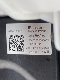

I have a ‘17 (only 21,724 miles) that’s 4 1/2 months out of warranty. I was out of town for a month and when I returned 2 weeks ago it started doing the tap-tap-tap thing. Definitely the iBooster. I checked when opening the car door and got down by the brake pedal and it might’ve actually been moving very slightly; a push on it with my hand and it stopped the sound and movement. I’ve also pumped the brakes gently while powered up but parked, and it went away.
I appreciate this forum which helped me to identify the problem, and my experience is the same as those who’ve had this issue.
I guess Monday I’ll see if GM is going to cover this or if I’ll be out-of-pocket on it. I’ll get it fixed either way, I’m not going to live with it. I’ll follow up to let you know if GM will cover it out of warranty.
