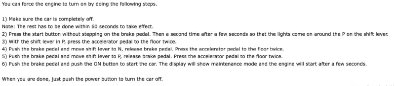

I hate to display my ignorance, but what is "maintenance mode" on the Clarity? I can't find any reference to it in the Manual.
Maintenance mode allows one to start the car with the ICE motor running continuously for diagnostic purposes or to warm the engine to change oil and perhaps other reasons.
I found it in another thread. Can't recall if it was here, or ClarityForums.
FWIW, I found what seems to be the initial reference to the procedure in a post #23, by jeff628, in the thread "Oil Change Frequency for Clarity", There wasn't any source given in that post either, but apparently it works, and you were able to use it.
Good info to have, but I would definitely not be able to do it without reading along.
Actually after step 5 (shift to P and press the pedal twice) Maintenance Mode appears on the screen, but the engine will not run until you do step 6 (press brake and push the power button) that's when the engine will start.
Also after step 4 (shift to N and press the pedal twice) a message will appear "Gear Position is N, Release Accelerator Pedal". You can ignore this message.
Also it is advised to not try and drive in maintenance mode. Why I don't know, I read that for the Prius Prime which uses the exact same sequence it said that you could fry your inverter. I don't know if that is true for the Prime or for the Clarity but probably best to not experiment and find out.

No, like Thomas Mitchell said they are just sort of bouncing around on various sites, you will see this if you do a Google search, as it seems to be the standard procedure for all Honda and Toyota hybrids. Not all of them warn about not driving in maintenance mode, but I know I have seen that on some of them. I'm guessing there is an official version on the Honda Service Express website but that is a paid site. The one day cost is not so bad, some people have paid for one day and downloaded as much as they could.
I used this maintenance mode once (I think it was the 1st oil change). But honestly, it just seems easier to go for a short drive in HV mode if the goal is to warm up the engine. By the time you locate this procedure (impossible to remember) and execute it properly, you can drive around the block 3 times !
Yes, notes on maintenance mode are in the Honda maintenance manual.

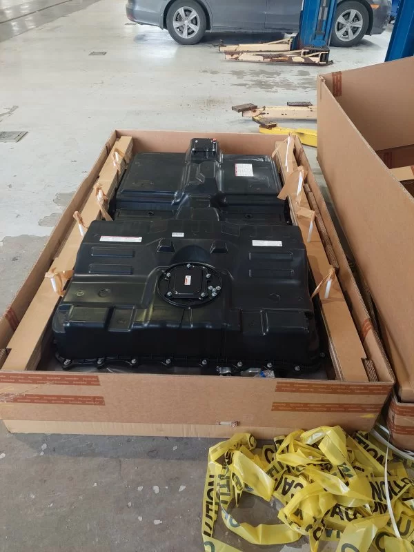

I was told it is a new battery, not a refurb.
I’d image Honda has a stash of new batteries from the assembly line. It’s much easier to send out a complete unit than to hobble together another pack. It would be interesting to know what becomes of the defective batteries. It could be a single bad cell or just a faulty connection. If I had to guess, I’d say that Honda just sells them off to a salvage operation.
We’re now 4+ years since the car was available for sale and the battery technology is essentially 10 years old. It will be interesting to see what replacement battery will be provided under warranty 5 years from now.
