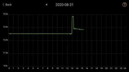

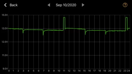

The last previous drive was on the 18th. Between then and the 24th, there were times it charged every four hours or so, as in the graph at the top, and times when it charged about every 24 hours.
It has still not charged since the 24th, and is at 12.52v this morning.
Seems to me that the voltage has dropped faster in the past. I wonder if the car decided to go into a low activity state, or I put it into one accidentally, and the lack of charging is just responding to the lack of need to charge. I suppose I could ping it by checking status with the app, but I'm curious to see what will happen like this. Although at this rate it could be much longer than I want to avoid using the car for.
That's what I'm thinking and that's based on the past observation that a short drive does not disturb the aux battery saver's existing time schedule, while a longer drive does, perhaps longer than approx 30 min.
But it's odd that the 4-hour charge events have not raised the voltage level as would be expected. Is this the same aux battery that has suffer a number of deep discharges or has it been replaced?
You made it nervous with all those questions, so it charged today.
Yes, this battery has been fully discharged two or three times, plus the times I caught it in the act, once around 11.8v and the other time well below 9v. But it held up fine for the week when the Kona didn't charge it. When it has trouble keeping a charge is when it's charged close to 13v.
Does everyone see that pattern of charging every 4 hours, or is it just my problem car?
Well, 4 hours is the expected post-BMS-update behaviour but it seems you're the first to report on longer periods of being parked. I don't have the update yet.
