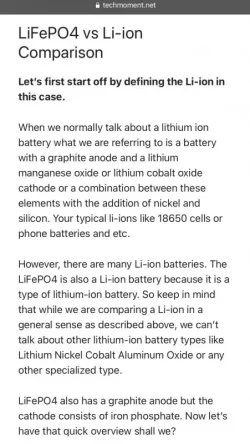

Here’s a screenshot from a techmoment.net article which states that LiFePo4 is a Lithium-ion battery. Yes, there are different chemistries and characteristics.

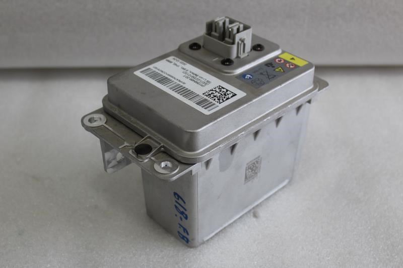

We also have a 2023 Tesla. Tesla now uses a Lithium Ion battery for the low voltage systems. Hopefully it will last a long time, but it is quite expensive if it fails (I think around $800). Of course, it is only available from Tesla, and it is not simply a 2-pin device (there are other connections, precluding the use of a generic battery). In addition, it is nominally 15.5V, but rated at only 6.9 Ah. This causes some issues like the auxiliary power outlets have 15.5V which could damage electronics that you might plug in. You certainly have to be mindful of this or risk damaging something. It is a little hard to believe that the Tesla is OK with a measily 6.9 Ah battery and the Clarity needs so much more. Of course, I am not certain whether the Tesla can invoke the HV battery to charge the 15.5V one when the vehicle is off. Many unknowns there...
The Tesla battery looks like this:
