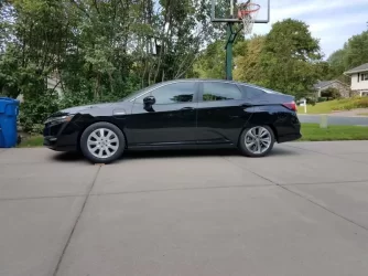

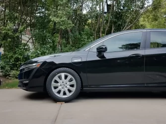

  15. Richard Kelly
    Richard Kelly Member
    Sorry to bring up an old thread, but I just got my Clarity last month and got the snows for the upcoming Minnesota Winter. Wheel take-offs from an older Accord and 215 55 r17 Blizzaks WS80 at the Discount Tire Labor Day sale. Package about $650 all in.
