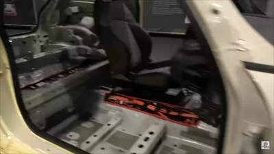

    BMW went to battery-maker CATL to get more advanced batteries they could stuff into the former exhaust-system tunnel between the front seats and the space vacated by the gas tank under the rear seats. BMW says the MINI Cooper SE's batteries are less prone to cold-weather range-reduction than the i3 battery. I've speculated that the SE's battery packaging may make it easier to keep the battery warm, which would also help prevent cold-weather range-reduction.
    You can see the battery in a cutaway MINI Cooper SE at the Plant Oxford factory in this video starting around the 1:30 mark.
