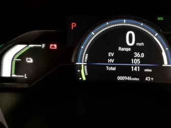

  7. Ken7
    Ken7 Active Member
    Just so we're all on the same page, here's a picture of the gauges in question. In the center is the numerical readout of the electric range, shown as 'EV'. In this case it's 36 and the battery is fully charged. On the left is the graphical depiction of battery charge that I find almost useless. It will show this same full state even after I've shaved off 6 or 7 miles of my actual electric range.
  8. Viking79
    Viking79 Well-Known Member
    The confusing one is go to View Information on the center screen and select the option Vehicle Energy it think it is called, the one that shows where the power is coming from or going to.
    The center console has a gauge that shows range and the car can be full, but if range is less than EPA range it looks like it is only partway full, even if the "fuel" style gauge on the left looks like your picture.
    I dont know if HondaDriver is looking at just the range guestimate number, the fuel style gauge (which presumably shows full), or the other range gauge that loos like a fuel gauge on the center console which can also be misleading, presuming BEV version has it.
