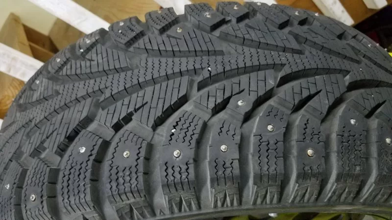

I brought my Nokian Hakkapeliitta snow tires to the dealer last December and had their resonator-knowledgeable technicians put them on as part of my purchase arrangement. It was a good decision because a 6-inch snowstorm hit the night before we took delivery. Because I don't like the looks of the expensive, resonator-equipped OEM wheels, I left the snow tires on those rims, purchased the more attractive (and much less expensive) Clarity accessory wheels, and had the dealer put the OEM tires on those rims. That way I didn't have to worry about center hub diameter, offset dimension, variations in lugnut design, etc. Another benefit: no plastic spokes! I can't detect any difference the resonators make.
Nice... how much those stuffs cost for you from your dealer?
I bought the snow tires online for about $800 and the dealer charged a little over $1,000 for the 4 wheels. Then I got extravagant and bought an electric impact driver and a new torque wrench to make it quicker to switch wheels in fall and spring.
Each wheel/tire weighs 55 lbs, so I'm not hoisting them up a ladder into the attic of the garage like I do with the 35-lb wheel/tires for my little 2006 Insight. Instead, I roll (bump) the Clarity wheels down the basement stairs. I have an electric jack that definitely has to work harder to raise the 4,059 pound Clarity than my 1,850-pound Insight. I don't know what I'd do if I couldn't change the wheels myself because if I couldn't handle that task, I probably couldn't handle stuffing the wheels into the Clarity to have someone else change them.

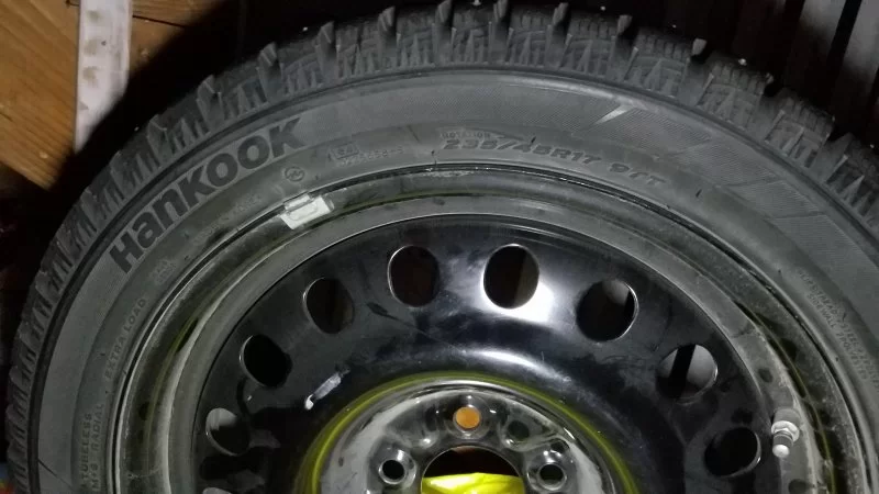

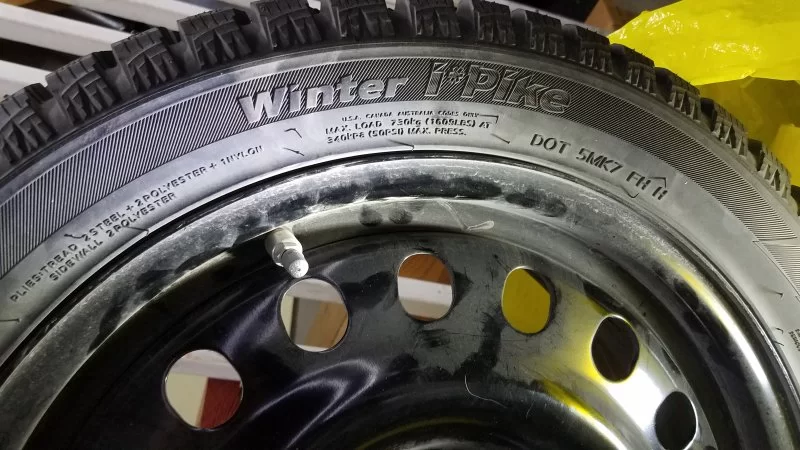

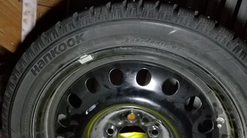

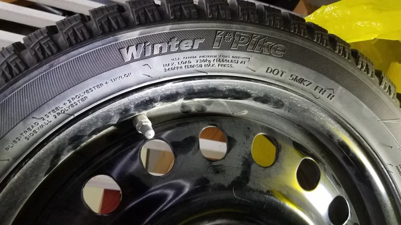

David, how are the 17" wheel working on the Clarity. What tire size did you use? I am looking for a good deal now after the winter passes. I have this sweet deal for 235/45R17 on wheels for $120, all 4. Just wandering if they will work on the Clarity, the car will be 1/2" lower.20180515_184745.webp 20180515_184919.webp 20180515_185041.webp
David, how are the 17" wheel working on the Clarity. What tire size did you use? I am looking for a good deal now after the winter passes. I have this sweet deal for 235/45R17 on wheels for $120, all 4. Just wandering if they will work on the Clarity, the car will be 1/2" lower.View attachment 3747 View attachment 3748 View attachment 3749
The 17" wheels work fine, but I used 215/55 tires of the same diameter as the originals. If the ones you want to use lower the car 1/2", that means they are 1" smaller in diameter, and that is a pretty big change so your odometer and speedometer will be off about 4%. I don't think I would be willing to go that far off on a near new car. but if you do it let us know how it works.
