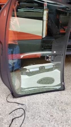

Windshield replacement.
David in TN
Out with the old...

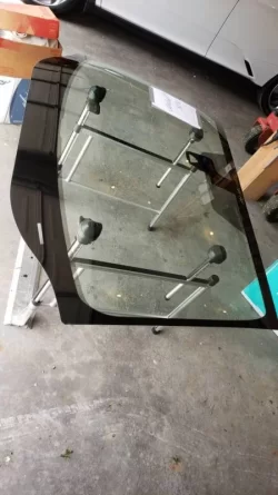

Yes price please, I realize it's probably paid for by insurance but if so if you don't mind calling the shop (or dealer) and asking what the price was. Also the model number of the windshield, even assuming it's OEM, which should be somewhere on the lower edge, hopefully visible. If not visible than maybe it's on the paperwork, or again the dealer or shop can tell you. This may seem trivial but as time goes on I can almost guarantee we are going to be discussing model numbers of windshields, because it can make a difference. If later someone has a problem with say wind noise they can at least know if they got the same model windshield as others so they know if it's the windshield itself or an installation issue. And when getting a windshield replaced it's a good idea to make a note of the old model number and see if they install the same model number. There may be a legitimate reason for a different number (old model discontinued etc) but still it's worth knowing, and asking about. A noisy windshield or a distorted one can be pretty hard to ignore. Not sure if we will ever have non-OEM windshields available considering the low volume, but if so that's when model numbers really get important.

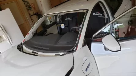

I haven't driven it yet, so no knowledge of if the camera is even working. We did check the wipers for proper alignment and function. They had an issue with the mount of the camera - it seems that the clip that holds it to the windshield mount was bent slightly and they had to bend it another way to get the camera unit to click into the windshield mount.

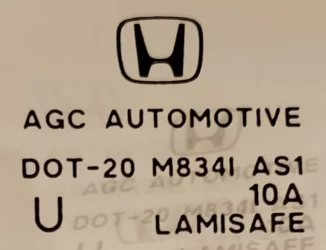

I looked at my windshield, the info is visible in the lower corner driver side, see photo. Honda logo but made by AGC Automotive, Lamisafe is their trademark name. Model number is M8341. Safelite has been licensed in the past to manufacture and sell AGC windows under AGC's AP Tech brand name, so maybe we will eventually have a non-OEM glass available through Safelite, even if Pilkington never makes one.
I don't see anywhere that it says it is acoustic and no "ear" symbol, but maybe 10A is an AGC identifier for acoustic, as I can't imagine we don't have acoustic windshields.

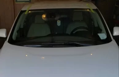

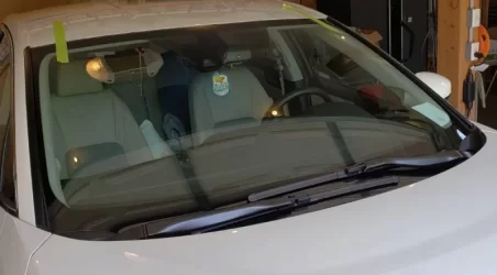

I took it for a test run. LKAS seems to work ok. No calibration done. I'll be doing 80+ miles tomorrow so we'll see how it goes.
If necessary, I can have a dealer do whatever magic needs to be done.

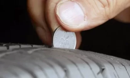

By the way we also use quarters to measure tread depth, it's 4/32 to the top of Washington's head and 2/32 inch to the top of Lincoln's head
I didn't realize you use Canadian nickel's for this, 2/32" to the top of Queen Elizabeth's crown. Although I guess you have to find an older coin for this
