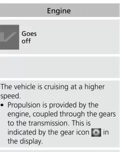

I sometime drive on highway in HV mode at the speed about 110-130 km/h, I believe at that speed the ICE will be clutched to power the wheel. The Owner's manual (page 14) says: "The vehicle is cruising at a higher speed.●Propulsion is provided by the engine, coupled through the gears to the transmission. This is indicated by the gear icon in the display." but I have no idea where the "gear icon" suppose to appear since I have never seen it or I missed it. Does anyone have seen that icon when driving?
