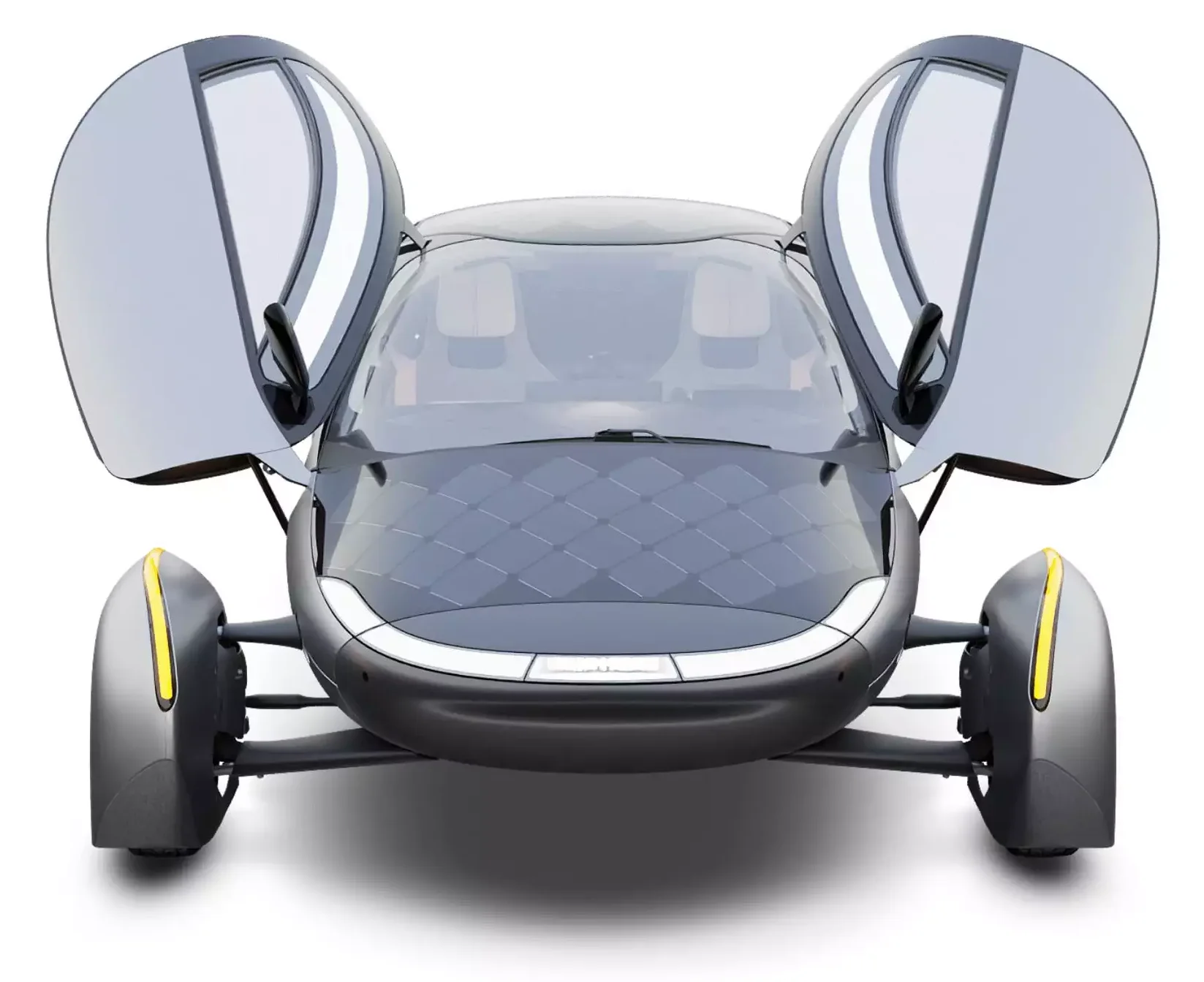

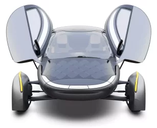

Regarding the width of the open butterfly doors, It looks like it is more than a couple inches wider than the wheel pants to me in photos, but I haven't seen the Aptera in person. It would be cool if someone could measure that for me.

As of this moment, Aptera has only ONE rolling validation vehicle on the road - so they've not made any changes to its dashboard. We've heard that there are a number of options that they will be testing - including coatings and lenticular films - but the current glare only happens when the sun is high in the sky and the vehicle is pointed in a very specific direction.
When open the doors extend a few inches beyond the wheel pants so they will be within the bounds of a standard parking space. I've attached a digital rendering.
