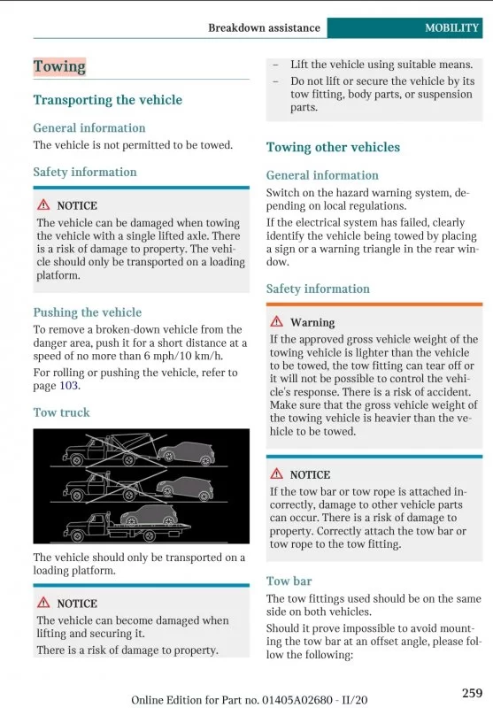

I see in the manual that the SE cannot be towed, even if using a dolly on the forward wheels. With the aft wheels freewheeling on a front wheel drive car, I don't understand this prohibition.
With it's small size and capacity to be "refueled" at the campground, I would think the Mini would be desirable as a dinghy, if not for this limitation.
Anyone know why this is?
