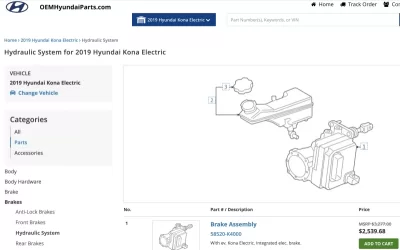

I'll add something else to this somewhat dreary subject, our shared brake master cylinder costs around US$2500 at a parts supplier, twice the cost of the gear reducer that could benefit from preemptive rather than just scheduled maintenance.
