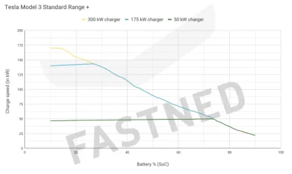

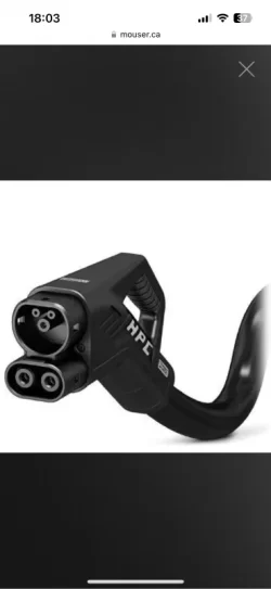

A gas pump cable is thinner and lighter and the connector end, the nozzle itself, is small and goes into a tapering hole in the car in any orientation. Anyone can handle them. The CCS connector got is a very different beast.
Anyone who thinks the CCS connector is not clunky hasn’t watched a 5 foot 110lb woman try to deal with getting it lined up perfectly with the angled CCS port on the Mini. Especially when it’s cold and the cable is stiff.
There is a video on YouTube of a guy in a wheelchair that got flipped backwards when he tried to do it.
The NACS connector is not only smaller, the port is self guiding (it tapers as it goes in and the squarish shape causes the connector to rotate itself to guide itself in). And the Tesla cable is easier to handle as it’s thinner.
It’s not about slimline looks, the connector itself is easier to use.not everyone is a healthy 6 foot 200lb engineer.
Again, it’s not that we couldn’t live with it if we had to, it’s just demonstrably inferior is all.
