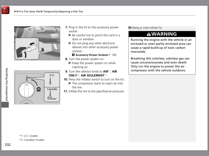

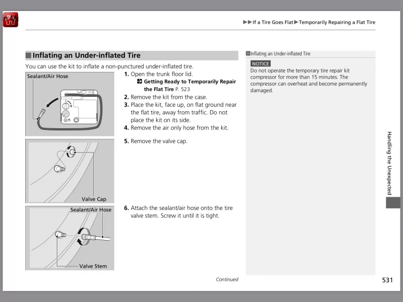

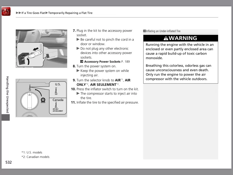

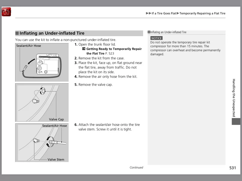

I did not know that. Thanks. I had mine from the previous car, but now I can give it to someone else.
I was concerned that the tire leak plugging material in the pump that came with the Clarity could get into the tires during normal tire pressure adjustments. I ended up buying an inexpensive air only pump for that purpose.

I’ve been using the Honda included pumps since at least my 2013 Civic hybrid. I’ve used the pumps included with my wife’s Kia Optima Hybrid and Niro as well as in my Clarity to top up the tires. Keep in mind if you have nitrogen fill you are diluting it and adding a little moisture to the mix in the tire. I am, however, not 100% sold on nitrogen fills.
