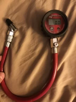

So glad I checked this thread. Just measured my tires (car is about a month old) and the PSI was50 in each tire. I deflated them to about 42 and probably need to deflate some more. The car is sitting in the garage so I assume that I should get it down to the "cold" reading of 36. I used my bicycle pump to check the psi since I had nothing else. I'm going to get one of the gauges referenced on this site.
